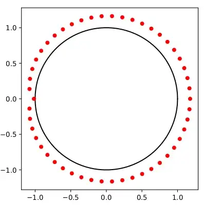

I am interested in characterizing the roots of the partial sum $$ s_n(z) = \sum_{k=0}^n \left( \begin{array}{c} \frac{1}{2} \\ k \end{array} \right) z^k. $$
The $n$ roots all seem to lie outside the unit circle and asymptotically approach the unit circle (and the roots seem to have equally spaced arguments). For instance, for $n=50$, the roots (red dots) look as follows in the complex plane (solid black circle denotes the unit circle): enter image description here

    Not sure if this helps, but it looks like they are forming some sort of cardioid. – wormram Dec 31 '20 at 01:53
    A similar question has been asked here. – Jean Marie Dec 31 '20 at 02:19
  • Certainly caused by the asymptotic expansion of $\frac{{1/2\choose k}}{{1/2\choose n}}$ (for $k\le n$) in powers of $1-k/n$ – reuns Jan 01 '21 at 15:18
  • Sorry for entering late in the game, but I guess you are considering the Szegö curve. I am no expertise on this topic, but this keyword would reveal a lot more about zeros of Taylor polynomials. – Sangchul Lee Jul 14 '22 at 12:37
