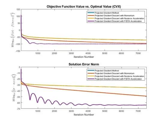

I implemented the solution in MATLAB and got the following results compared to CVX:
The iterative methods are slower than CVX for this task (I used MOSEK).
Yet, this is on small size of the data. Probably they will be able to be faster for large scale problem (Still you'll have to give a solver a lot of time to get the result).
I'd also recommend adding Line Search. As this problem is not well poised.
