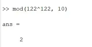

I try to use $$122^{122} = 2^{122} (\mod 10)$$
But I use MATLAB that $122^{122}=2 (\mod 10)$ and $2^{122}=4 (\mod 10)$. Why they are not the same? The screenshot is as follows:

I no longer have access to Matlab so I can't reproduce this error exactly on my end. A similar mistake is observed when I use Octave online:
octave:2> mod(122^122, 10)
ans = 0
You should use a function such as powermod. The trick is we do not want to compute $122^{122}$ explicitly.
Notice that $122^{122}$ is a very large number and it is working in double precision float point that exceeds flintmax. Above this value, double-precision format does not have integer precision, and not all integers can be represented exactly.
The answer is indeed $4$.
Here are the Python outcome:
>>> 122**122 % 10 # cool, it can be computed
>>> pow(122, 122, 10) # preferred.
