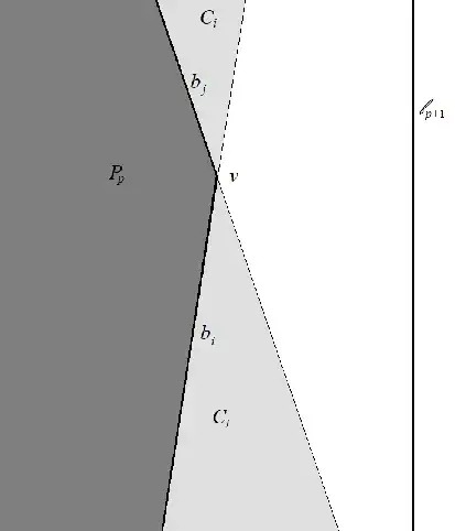

Next he proves the second case: Two of the lines $\ell_1$ and $\ell_2$ intersect. The cylinders of radius $1$ about them, $C_1$ and $C_2$ therefore intersect to form a parallelogram (actually, a rhombus). This is a closed polygon. Number the cylinders about the remaining lines as $3$ and on in some arbitrary order.
Now we note a couple things about the Sets $P_k = \bigcap_{i=1}^k C_i$, for any $k \ge 2$. Because the intersection of convex sets is also convex, each $P_k$ is convex. Further, if $P_{k-1}$ is a polygon and $P_k \ne \varnothing$, then $P_k = C_k \cap P_{k-1}$ is also a polygon. This is because the intersection just cuts off from $P_{k-1}$ the portions that extend beyond $C_k$'s two boundary lines. And since $P_2$ is a polygon, by induction, so are all the $P_k$ for $k > 2$.
Now suppose that $\bigcap_{k=1}^n C_k = \varnothing$. Then there has to be some largest $p < n$ such that $P_p = \bigcap_{k=1}^p C_k \ne \varnothing$. Now since $p$ is the largest possible, $P_p\cap C_{p+1} = \varnothing$, and in particular $P_p$ does not intersect the line $\ell_{p+1}$. Dave uses an optimization argument to prove the intuitively obvious fact that the closest point of the solid polygon $P_p$ to $\ell_{p+1}$ will be some vertex $v$ of $P_p$. Label the two boundary segments meeting at $v$ by $b_i$ and $b_j$. Because of how the polygon $P_p$ is formed, these segments are parts of the boundaries of two cylinders $C_i, C_j$ for some $i, j \le p$. Now $b_i$ and $b_j$ are at best parallel to $\ell_{p+1}$, or else they slant away from $\ell_{p+1}$ as you move away from $v$. Otherwise $v$ would not be the closest point of $P_p$ to $\ell_{p+1}$.
But the intersection $C_i\cap C_j$ is a rhombus lying on the same side of $b_i$ and $b_j$ as its subset $P_p$. Which means that $v$ is also the closest point of $C_i\cap C_j$ to $\ell_{p+1}$. But $v \notin C_{p+1}$, so it is a distance of more than $1$ away from $\ell_{p+1}$. Thus the same must be true of every point of $C_i\cap C_j$ to $\ell_{p+1}$. In particular, $C_i\cap C_j \cap C_{p+1} = \varnothing$, which means there can be no circle intersecting all three of $\ell_i, \ell_j, \ell_{p+1}$, a contradiction.
