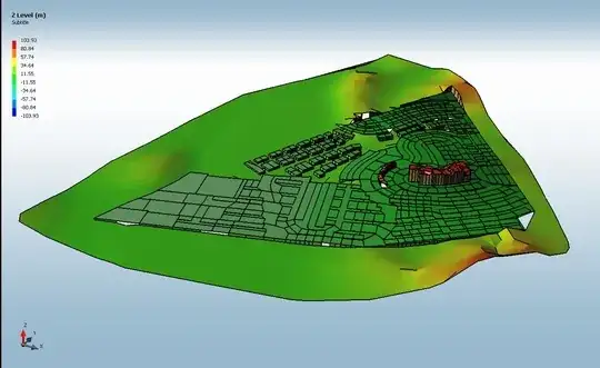

I have a terrain, which is defined by mesh. And there are a lot of other polygonal faces scattered throughout the terrain, they can be located above, or below or cutting through the terrain. You can think of those faces as platforms.
A screenshot below should clarify what I mean. Despite looking smooth, all the mesh are actually consist of small elements ($\text{number}> 10k$) combined together, giving the false appearance of smoothness. The obvious disconnected area are platforms.
