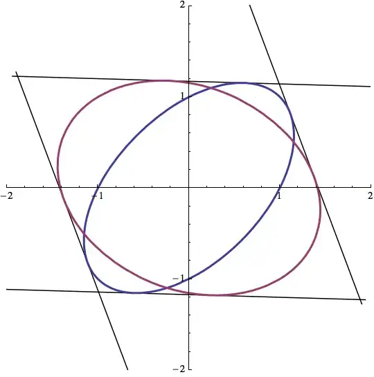

You can use Solve rather than NSolve but the resulting expressions are quite complicated. Let's visualize, as well.
line[{pt1_, pt2_}] := ParametricPlot[t*pt1 + (1 - t) pt2, {t, -2, 3},
  PlotRange -> 2, PlotStyle -> Black];
lines = line /@ pts;
cp = ContourPlot[{
  f1[x, y] == 1,
  f2[x, y] == 4
}, {x, -3, 3}, {y, -3, 3},
ContourStyle -> {{Thick, ColorData[1, 1]}, {Thick,
  ColorData[1, 2]}}];
Show[Flatten[{lines, cp}], PlotRange -> 2]

Using the example from Mark McClure’s answer, we have $$A = \begin{bmatrix} 1 & -\frac12 & 0 \\ -\frac12 & 1 & 0 \\ 0&0&-1\end{bmatrix} \\ B = \begin{bmatrix} 2 & \frac12 & 0 \\ \frac12 & 3 & 0 \\ 0&0&-4 \end{bmatrix}.$$ (Note that I’m using the constant terms from the Mathematica code, which are swapped from those in the text of the answer.) Inverting these and multiplying by some arbitrary-looking scalars to make things look tidier, we get $$A^* = 3 A^{-1} = \begin{bmatrix} 4 & 2 & 0 \\ 2 & 4 & 0 \\ 0&0&-3 \end{bmatrix} \\ B^* = \frac{23}2 B^{-1} = \begin{bmatrix} 6&-1&0 \\ -1&4&0 \\ 0&0&-\frac{23}8 \end{bmatrix}.$$ The resulting system of equations is $$4 \lambda ^2+4 \lambda \mu +4 \mu ^2-3 \tau ^2 = 0 \\ 6 \lambda ^2-2 \lambda \mu +4 \mu ^2-\frac{23}8\tau ^2 = 0.$$ In this case both ellipses surround the origin, so we set $\tau = -1$ and solve. Turning to Mathematica, we obtain the solutions
{{lambda -> 0.0246484, mu -> 0.853438}, {lambda -> -0.0246484, mu -> -0.853438}, {lambda -> -0.703267, mu -> -0.264046}, {lambda -> 0.703267, mu -> 0.264046}}
which you can verify are the same lines as those computed in Mark McClure’s answer.
