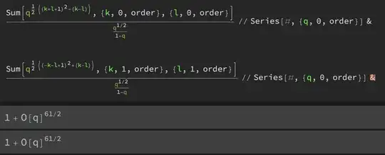

I have checked this equality with Mathematica to a very high order:
However, I wonder how to prove it? Is it (or its generalization) discussed somewhere? (the sum smells like some $\Theta$-function, but I don't know where to look).
