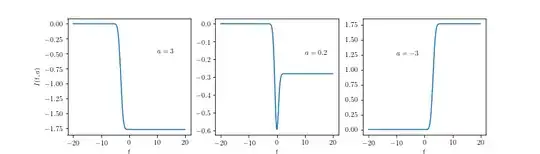

I got three graphs for different $a$ enter image description here
therefor one can speculate the behavior of the integral for $|a|\ll1$ is as a Bi-gaussian function and for $|a|\gg1$ is as an $\mathrm{erf}(t)$ function. therefore the answer is something like this $$ I(t,a) \sim \alpha(a) \ \mathrm{erf}(t+a) + \beta(a) \ e^{-(t\pm a)^2} $$

Limited to first order, this would give $$\frac{\sqrt{\pi }}{4} \left(\text{erf}(t)^2-1\right)+a \left(e^{-t^2} \text{erf}(t)+\frac{\text{erfc}\left(\sqrt{2} t\right)-2}{\sqrt{2}}\right)+O\left(a^2\right)$$ which perfectly matches your plot for $a=0.2$.
