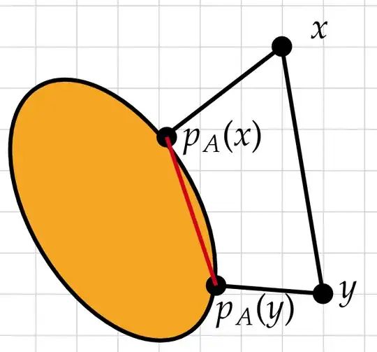

One notable property of metric projections is that they are contracting, meaning that $$\|p_A(x)-p_A(y)\| \le \|x-y\|,\quad\forall x,y\in\mathbb R^n.$$ Geometrically, this is pretty clear from figures such as this:

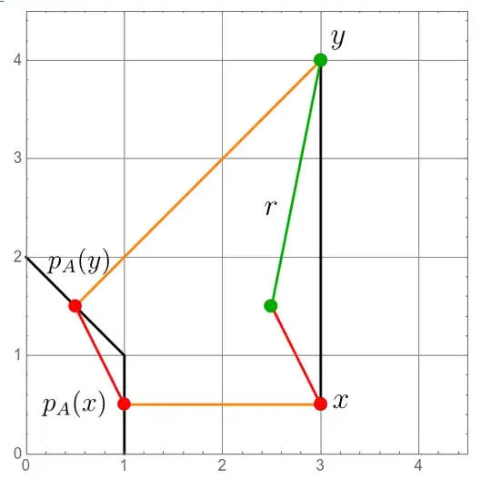

From this result, you can get that the projection is contracting in the following way. You have
$$\begin{aligned} \Vert x - y \Vert^2 &= \Vert p_A(x) - p_A(y) + r \Vert^2 \text{ where } r= (x-y) + (p_A(y) - p_A(x)\\ &= \Vert p_A(x) - p_A(y) \Vert^2 + \Vert r \Vert^2 + 2 \langle r, p_A(x)-p_A(y) \rangle\\ &= \Vert p_A(x) - p_A(y) \Vert^2 + \Vert r \Vert^2\\ &+ 2\langle x-p_A(x), p_A(x)-p_A(y) \rangle +2 \langle y-p_A(y), p_A(y)-p_A(x) \rangle \end{aligned}$$
And you can conclude as $$\Vert r \Vert^2\\ + 2\langle x-p_A(x), p_A(x)-p_A(y) \rangle + 2\langle y-p_A(y), p_A(y)-p_A(x) \rangle \ge 0.$$
An image (courtesy of glS) describing what happens: enter image description here
  • if I'm reading this correctly, this is essentially another way to state that the supporting hyperplanes separate $A$ from its complementary, together with the fact that there is a supporting hyperplane passing through each $p_A(x)$ (which follows from the fact that there is a supporting hyperplane at every element of the boundary). I'm failing to see how this can be used for the proposition under exam though, as we here need to control two different points and their projections. – glS Aug 31 '20 at 15:14
  • I do agree with the first part of your comment. Regarding the second part, see my updated answer. – mathcounterexamples.net Aug 31 '20 at 15:27
  • very nice, thank you! I made a graphical representation of the construction, https://i.sstatic.net/LZ6pQ.png, if you want to add it to the post for better clarity. The gist, as I understand it, is to show that $x-p_A(x)$ and $y-p_A(y)$ point in diverging directions (which you can show using the statement you pointed out) which implies that the angle between $x-y$ and $r$ is obtuse – glS Sep 02 '20 at 09:20
  • Thanks. Image is indeed useful and I updated my answer using it. – mathcounterexamples.net Sep 02 '20 at 09:29
