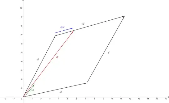

By the figure above, $$\vec u = \vec v+ \alpha \vec w$$ with $\alpha \in [0,1]$. See that the vector $\vec u$ takes the "border" of the parallelogram. Furthermore, if we take $\beta \vec u$ (green vector) with $\beta \in [0,1]$ we get interior points of the parallelogram.
In this case, the vector $$\beta \vec u = \beta \vec v + \beta \alpha \vec w$$ when we vary $\alpha$ and $\beta$, the vector $\beta \vec u$ takes all interior points of the upper triangle shaped by $\vec v$ and $\alpha \vec w$. You just need to make the necessary changes to get the lower triangle.
Can you finish?

  • you are taking some vector $\vec{u}$ such that $\vec{w}=\vec{u}+\alpha\vec{v}$, after that I don't understand. – SOORAJ SOMAN Aug 11 '20 at 13:25
  • @ss1729: I updated the answer. Please, see if it satisfies you. – Arnaldo Aug 11 '20 at 14:22
  • @ss1729, be carefull, there is no inequality for vectors. – Arnaldo Aug 11 '20 at 16:40
  • A general vector inside $\sqsubset ! \sqsupset OADB$ is $\vec{r}=a\vec{v}+b(\vec{v}+\vec{w})$ or $\vec{r}=\alpha\vec{w}+\beta(\vec{v}+\vec{w})$ with $a+b,\alpha+\beta\in[0,1]$ and $a,b,\alpha,\beta\in[0,1]$. $\vec{r}=(a+b)\vec{v}+b\vec{w}=c\vec{v}+d\vec{w}$ or $\vec{r}=\beta\vec{v}+(\alpha+\beta)\vec{w}=c\vec{v}+d\vec{w}$ with $c,d\in[0,1]$, is it right ? – SOORAJ SOMAN Aug 12 '20 at 07:39
    @ss1729: That is right! – Arnaldo Aug 12 '20 at 12:55
