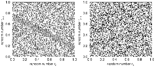

Goal: Find a rigorous, quantitative, computable metric to capture the visual intuition that a picture of the output of a linear congruential generator that is without shuffling is somehow "less random" than one with shuffling. For example, it is visually obvious that the output on the left is "less random" than the output on the right, but left and right might both fare as well on a K-S test:
Linear congruential PRNG with and without shuffling
This motivates the idea of quantifying the sense that one output is "more random" than another, while still knowing that both are obviously not random at all because they are both generated by a deterministic computer program. So what I'm looking for here is an intuitively satisfying quantification of relative randomness, while still being aware that neither output is, on it's own "truly random".

The spectral test goes directly at the exact same problem this question is framed around: We can construct two sequences, one of which is visually less "random" than the other, and yet both will give back the exact same Chi-squared test results. So the question is how to measure the "randomness distance" between the two pictures, i.e. how to quantify the increase in randomness of one picture over the other.

    That's sort of a good point but it doesn't capture the intuition of the picture you see when you have a linear congruential generator without shuffling (https://possiblywrong.wordpress.com/2013/05/12/random-number-generation-in-simulink/) versus one with shuffling. In particular, the sense of "looks much better" in this doc: http://www.sci.csueastbay.edu/~btrumbo/Stat3401/Hand3401/CongGenIntroB.pdf I think compression (without knowing a priori how the data was constructed, i.e. more of a hashing/Bitcoin kind of problem) does capture the intuition. – Lars Ericson Jul 28 '20 at 14:20
