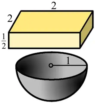

Suppose you are a college student preparing one of those cuboid-shaped instant noodle packages. You plan on breaking the noodles such that each piece can be entirely submerged by boiling water (i.e; below the top of the bowl).
noodles and bowl
The noodles have dimensions $2\times2\times\frac{1}{2}$, thus having volume $$V_{n}=2$$ Meanwhile the bowl is a hemisphere of radius $1$ $$V_{b}=\frac{2\pi}{3}\approx2.094$$
Clearly, the bowl has just enough room to fit the noodles. Accordingly,
What is the minimum planar-breaks required to fit the noodles in the bowl?

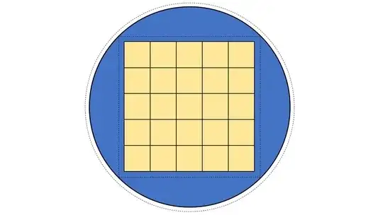

$\textbf{Building the layers}$. Now let us try to build the single layers. In each of them, within the corresponding circle with radius $r_j$, we can firstly place the cubes side by side to form the largest possible square contained in the circle. The best possible case is a square with side $r_j \sqrt{2}$ inscribed in the circle. However, since we have to cover this square using cubes with side $h$, the largest possible square contained in a circle with radius $r_j$ actually has a side given by
$$s_{j,h}=h\left\lfloor \frac{r_{j,h} \sqrt{2}}{h} \right\rfloor$$

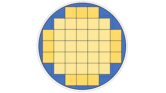

The figure below shows an example for the bottom layer in the case $h=1/4$, as seen from the top. The cubes in this layer have to be placed within the circle with radius $r_{1,\,1/4}=\sqrt{1-(1/4)^2}$ $=\sqrt{15}/4\approx 0.968$ (showed in blue), slightly smaller than the circle with radius $1$ that forms the flat face of the hemisphere (dotted circle). The inscribed square (dotted square) has side $=\sqrt{30}/4\approx 1.369$, but since we have to form the square using cubes with side $1/4$ we can get a smaller one, with side $s_{1,\,1/4 }=1/4 \cdot \left\lfloor \frac{ \sqrt{30}/4 }{1/4} \right\rfloor=1.25$, covered by a $5 \times 5$ arrangement of the cubes.
In each layer, after we have formed the central square, we can try to fill the four remaining circular segment regions. To do this, we can begin by placing four row of cubes, each adjacent to one side of the square. Since the cubes have size $h$, the maximal width of these rows is not $s_{j,h}$, but $2\sqrt{r_{j,h}^2-(s_{j,h}/2+h)^2}$. So, on each side of our square, we can place a first row of $\lfloor 2\sqrt{r_{j,h}^2-(s_{j,h}/2+h)^2} /h \rfloor$ cubes. Repeating the process, we can place, externally to each of these rows, a second row of $\lfloor 2\sqrt{r_{j,h}^2-(s_{j,h}/2+2h)^2} /h \rfloor$ cubes, a third row of $\lfloor 2\sqrt{r_{j,h}^2-(s_{j,h}/2+3h)^2} /h \rfloor$ cubes, and so on. Generalizing, the $k^{th}$ group of four rows includes $4\lfloor 2\sqrt{r_{j,h}^2-(s_{j,h}/2+kh)^2} /h \rfloor$ cubes.
As already noted for the maximal number of layers, within any layer the maximal numbers of rows filling each of the circular segments is not $r_{j,h}/h$, since there is necessarily a distance between the external face of the most external row and the circle. Even in the best possible scenario that minimizes this distance (i.e., that where there is a single central cube in the more external row that touches the hemisphere with its two upper external vertices), the block of rows has a total width of $\sqrt{r_{j,h}-h^2/4}-s_{j,h}/2$. Again this is only a theoretical best scenario, because for any given $h$ the maximal number of rows that can be placed within the circle corresponding to the $j^{th}$ layer is
$$k_{max,j,h}=\left\lfloor \frac{ {\sqrt{r_{j,h}^2-h^2/4}}-s_{j,h}/2}{h} \right\rfloor $$
In the same example above, for the bottom layer in the case $h=1/4$, we would have
$$k_{max,1,\,1/4}=\left\lfloor \frac{ {\sqrt{15/16-(1/4)^2/4}-1.25/2}}{1/4} \right\rfloor =\left\lfloor \frac{\sqrt{59}/{8}-5/8}{1/4} \right\rfloor =1 $$
indicating that only a single row for each of the four circular segments can be added to the central square. These four rows contains a total of $4\lfloor 2\sqrt{15/16-(1.25/2+0.25)^2} /0.25 \rfloor=12$ cubes, i.e. three cubes each. Summing these cubes to those of the central square, we get a total of $25+12=37$ cubes. Accordingly, the figure below shows the completed bottom layer for this example, as seen from the top:

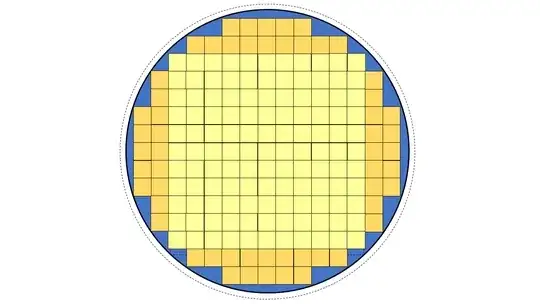

as confirmed here. In other words, in each circular segment region we can add a first row of $9$ cubes and a second row of $5$ cubes. The figure below shows the resulting bottom layer in the case $h=1/8$:
For the successive layers, using the formulas above it can be shown that $k_{max,j,1/8}$ is equal to $2$ for $1\leq j\leq 5$, and to $1$ for $6\leq j\leq 7$, as confirmed by WA here. Following the same method as above and making the appropriate substitutions, we get $T_{2,1/8}=160$, $T_{3,1/8}=148$, $T_{4,1/8}=129$, $T_{5,1/8}=104$, $T_{6,1/8}=69$, and $T_{7,1/8}=37$, as shown here and here. This leads to a total number of cubes given by $T_{1/8}=824$, corresponding to $80.5\%$ of the total set of $1024$ cubes. Since we cannot place all cubes in the hemispheric cavity, cutting our noodle package in cubes of side $1/8$ is therefore not sufficient to put it entirely in the bowl using this arrangement.

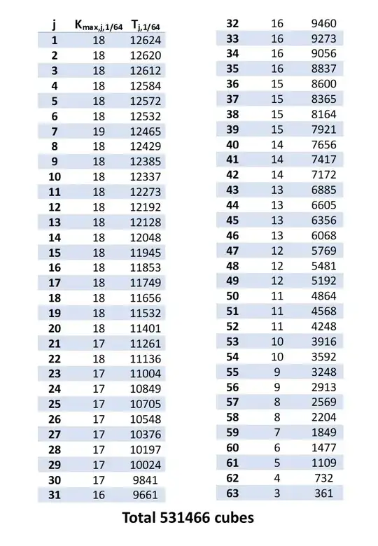

$\textbf{The case z=5}$. Finally, let us try with $z=5$ additional triple cuts. We obtain $2^{19}=524288$ cubes with side $h=1/64$ and volume $1/262144$. In this case our arrangement will have $j_{max,1/64}=1/(64)-1=63$ layers. To avoid an excessively long list of numbers in the text, I summarized the cube count for each layer in the following table:
The total count of cubes in our arrangement is $T_{1/64}=531466$, which is larger than our set of $524288$ cubes to be placed. This means that, in the case $z=5$, we have sufficient room to put all cubes in the bowl using a total of $4+3\cdot 5=19$ cuts. Assuming, in a more realistic way, to fill the bowl in its normal position with the curved base facing downwards, therefore starting from the smaller layer ($j = 63$) and continuing in sequence with increasingly larger layers, the final arrangement of this solution would completely fill all the layers except the major one ($j = 1$), which would be filled only for $56.9\%$.
