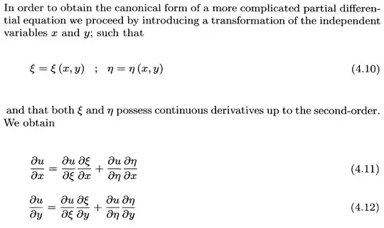

Section 4.2 Reduction to canonical forms, which leads to the development of the Laplace equation.

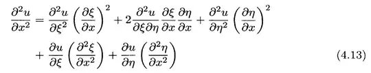

In this section, I don't understand how they expand the second-order partial derivative:
Formula of second-order derivative of u w.r.t. x
Where,
Exert from page 125.

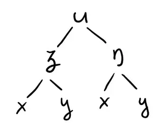

Here is what I got so far. When I do it, I only get to have 4 terms, and not 5 like what's in the book. Here I apply product rule first and then the chain rule (Note, I'm using square brackets to indicate that I am taking the partial derivative of whatever is in them. Just to keep it organized).
$$\begin{align} \frac{\partial}{\partial x}\frac{\partial u}{\partial x} &= \\ &= \frac{\partial}{\partial x} \biggl( \frac{\partial u}{\partial \xi} \frac{\partial \xi}{\partial x} + \frac{\partial u}{\partial \eta} \frac{\partial \eta}{\partial x} \biggr) \\ &=\frac{\partial}{\partial x} \biggl( \frac{\partial u}{\partial \xi} \frac{\partial \xi}{\partial x}\biggr) + \frac{\partial}{\partial x} \biggl(\frac{\partial u}{\partial \eta} \frac{\partial \eta}{\partial x} \biggr) \\ &= \frac{\partial}{\partial x} \biggl[ \frac{\partial u}{\partial \xi} \biggr] \frac{\partial \xi}{\partial x} + \frac{\partial u}{\partial \xi} \frac{\partial}{\partial x} \biggl[ \frac{\partial \xi}{\partial x} \biggr] + \frac{\partial}{\partial x} \biggl[ \frac{\partial u}{\partial \eta} \biggr] \frac{\partial \eta}{\partial x} + \frac{\partial u}{\partial \eta} \frac{\partial}{\partial x} \biggl[ \frac{\partial \eta}{\partial x} \biggr] \\ \text{Now the chain rule:}\\ &= \frac{\partial}{\partial \xi}\biggl[\frac{\partial u}{\partial \xi}\biggr] \frac{\partial \xi}{\partial x} \frac{\partial \xi}{\partial x} + \frac{\partial u}{\partial \xi} \frac{\partial^2 \xi}{\partial x^2} + \frac{\partial}{\partial \eta}\biggl[\frac{\partial u}{\partial \eta}\biggr] \frac{\partial \eta}{\partial x} \frac{\partial \eta}{\partial x} + \frac{\partial u}{\partial \eta} \frac{\partial^2 \eta}{\partial x^2} \\ &=\frac{\partial^2 u}{\partial \xi^2} \biggl(\frac{\partial \xi}{\partial x} \biggr)^2 + \frac{\partial u}{\partial \xi} \frac{\partial^2 \xi}{\partial x^2} + \frac{\partial^2 u}{\partial \eta^2} \biggl(\frac{\partial \eta}{\partial x} \biggr)^2 + \frac{\partial u}{\partial \eta} \frac{\partial^2 \eta}{\partial x^2} \end{align} $$ My tree of the chain rule looks like this (is it correct?)
hand drawn tree of the chain rule of u
In addition, if someone could explain why this chain rule is valid? Granted, this may be a whole topic on its own, so if you could just point to some resource or what this particular operation is called, that would do.
$$ \frac{\partial}{\partial x}\biggl[ \frac{\partial u}{\partial \xi} \biggr] = \frac{\partial}{\partial \xi} \biggl[\frac{\partial u}{\partial \xi}\biggr]\frac{\partial \xi}{\partial x} $$

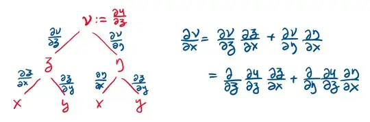

UPDATE:
(as per answer by @peek-a-boo)
chain rule tree of second order derivative of u wrt x
P.S. Corrections or edits are welcomed.

You have a mistake when calculating $\dfrac{\partial}{\partial x}\left[\dfrac{\partial u}{\partial \xi}\right]$ and $\dfrac{\partial}{\partial x}\left[\dfrac{\partial u}{\partial \eta}\right]$ in the middle where you're missing a extra step in the chain rule. For simplicity, just call $v:= \dfrac{\partial u}{\partial \xi}$. Then by equation (4.11), we have \begin{align} \dfrac{\partial v}{\partial x} &= \dfrac{\partial v}{\partial \xi} \dfrac{\partial \xi}{\partial x} + \dfrac{\partial v}{\partial \eta} \dfrac{\partial \eta}{\partial x}. \end{align} So, if we plug in the definition of $v$, we get \begin{align} \dfrac{\partial}{\partial x}\left[\dfrac{\partial u}{\partial \xi}\right] &= \dfrac{\partial^2 u}{\partial \xi^2} \dfrac{\partial \xi}{\partial x} + \dfrac{\partial^2 u}{\partial \eta \partial \xi} \dfrac{\partial \eta}{\partial x}. \end{align} Similarly, \begin{align} \dfrac{\partial}{\partial x}\left[\dfrac{\partial u}{\partial \eta}\right] &= \dfrac{\partial^2 u}{\partial \xi \partial \eta} \dfrac{\partial \xi}{\partial x} + \dfrac{\partial^2 u}{\partial \eta^2} \dfrac{\partial \eta}{\partial x}. \end{align} Finally, when you put all of this together, just remember that mixed partial derivatives are equal: $\dfrac{\partial^2 u}{\partial \xi \partial \eta} = \dfrac{\partial^2 u}{\partial \eta \partial \xi}$ (that's how the factor of $2$ comes up in equation $4.13$)
And yes, your chain rule tree looks right (that's how you can get 4.11 and 4.12). You can also create similar chain-rule trees for $\frac{\partial u}{\partial \xi}$ and $\frac{\partial u}{\partial \eta}$. As for why the chain rule is valid... well that's a completely different issue, which you should probably ask in a separate question if this answer isn't sufficient.

  • O-oh, I think I got it. I've updated my question with the tree for the chain rule of second-order (is it correct?). Can you just clarify, why, if $\nu$ is a derivative or u w.r.t. $\xi$, why do we include the $\eta$ components? – Jek Denys Jul 25 '20 at 20:22
    @JekDenys $v = \dfrac{\partial u}{\partial \xi}$, but this is still a function of two variables. More precisely, $v(\xi,\eta) := \dfrac{\partial u}{\partial \xi}(\xi,\eta)$. THis is one of the very hige pitfalls of Leibniz notation where you don't explicitly mention where the functions and derivatives are being evaluated. Because this is a function of $(\xi,\eta)$, you still need to take partial derivatives with respect to $\xi$ AND $\eta$ when applying the chain rule – peek-a-boo Jul 25 '20 at 20:24
