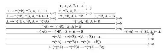

Sequent proof
Here we prove only the more difficult direction: the argument differs a bit from the other two, as it amounts to proving the desired goal via the lemma $(\neg\neg A \rightarrow \neg\neg B) \rightarrow (\neg B \rightarrow (A \rightarrow B)$.
sequent calculus derivation of the backward implication
