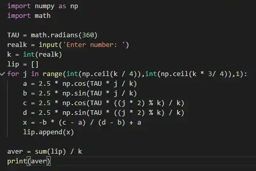

Guaranteed, it lies on the x axis so I need the x co-ordinate only. I tried to calculate it with a Python program to save myself time and it looks like this:
And the output looks very wrong like this:
Well of course I couldn't just pick any two lines that seem to pass through that point and say they intersect at the point of interest(or could I)? Point is, I have no idea. If there's uncertainty in the exact position of that point then maybe we're looking at an infinite series that could possibly have a clean looking answer. But as of now, I'm lost.

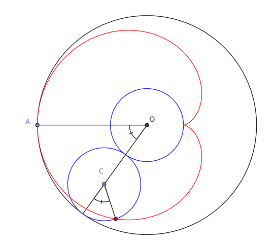

As explained at the end of that video, this works because a cardioid is the caustic produced by rays from a source sitting on the circle itself, at the position of number zero (point $A$ in figure below), and reflected by the circle itself.
But it is not difficult to show that this cardioid is also a roulette, generated by a point on a circle having a radius which is $1/3$ that of the large circle, rolling on a circle of the same radius, concentric with the large circle. The initial position of the tracing point is the same as the position of the light source.
A proof of that can be found on Wikipedia, see here for a geometrical proof.
I don't know if this fully answers your question: feel free to ask for more details.
  • So if I form the cardioid with two circles of radius 1/3 of the large circle I'm done – Nεo Pλατo Jul 03 '20 at 05:06
