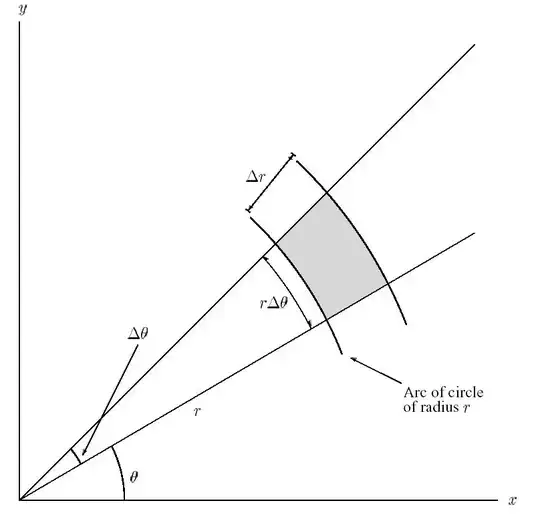

Generally speaking, a double integral always has an area differential, so that you're integrating $\iint dA$. Another way to view the question, then, is why $dA = dx dy$ in Cartesian coordinates and $dA = r dr d\theta$ in polar coordinates.
An area element in Cartesian is a rectangle, as Qiaochu describes in his answer. The area of the rectangle is the small change in $x$ times the small change in $y$, or $\Delta x \Delta y$.
An area element in polar, however, is a piece of a circle sector. There's a nice picture below taken from here. (The area element is the shaded part.)
polar area element
If the angle is measured in radians, we know that the area of a sector of angle $\theta$ of a circle of radius $r$ is $\frac{1}{2}r^2 \theta$. So the area of the shaded piece in the picture is $$\Delta A = \frac{1}{2}(r + \Delta r)^2 \Delta \theta - \frac{1}{2}r^2 \Delta \theta = r \, \Delta r \, \Delta \theta + \frac{1}{2}(\Delta r)^2 \, \Delta \theta.$$ The quadratic factor of $\Delta r$ makes the second term negligible compared to the first term for small enough $\Delta r$ and $\Delta \theta$. Thus in the limit we get $dA = r \, dr \, d\theta$.
As others have said, you can also use the multivariate change of variables formula involving the Jacobian of the transformation directly. I like the geometric argument when first introducing the polar element in a calculus course, though.

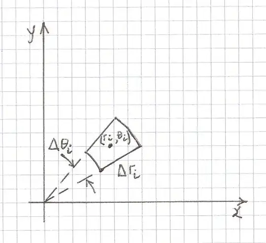

UPDATE: The series have been replaced by limits of sums.
Geometric interpretation. By definition of a double integral of a continuous function over a bounded closed region $R$ of the $xy$-plane, we have
$$\iint_R f(x,y)\;\mathrm{d}x\;\mathrm{d}y=\lim_{n\to\infty}\; \sum_{i=1}^{n }f(x_{i},y_{i})\Delta A_{i},$$
where $\Delta A_{i}$ is the area of a generic rectangular cell and $n$ the number of cells.
If $f(x,y)=1$, we get the area of $R$
$$ \iint_R \mathrm{d}x\;\mathrm{d}y=\lim_{n\to\infty}\; \sum_{i=1}^{n }\Delta A_{i}.$$
If we decompose $R$ into cells with a shape of sectors of a circle defined by two radii whose difference is $\Delta r_{i}$ for the generic $i^{th}$ cell and two rays making an angle $\Delta \theta _{i}$ with each other, the area of the cell, using the formula of a circle sector, is
$$\frac{1}{2}\left[ \left( r_{i}+\frac{1}{2}\Delta r_{i}\right) ^{2}-\left( r_{i}-\frac{1}{2}\Delta r_{i}\right) ^{2}\right] \Delta \theta _{i}=r_{i}\Delta r_{i}\Delta \theta _{i}\text{,}$$
where $r_{i}$ is the radius of the middle point of the cell. The same area $R $ can be expressed as the limit $\lim_{n\to\infty}\;\sum_{i=1}^{n }r_{i}\Delta r_{i}\Delta \theta _{i}$, which by definition of a double integral is equal to $$\iint_R r\;\mathrm{d}r\;\mathrm{d}\theta. $$
Figure: Generic $i^{th}$-cell in polar co-ordinates with the shape of a circle sector
This transformation is defined rigorously by the absolute value of the Jacobian of the transformation $\left\vert \frac{\partial (x,y)}{\partial (r,\theta )}\right\vert =r$ from the Cartesian to the polar system of co-ordinates ($x=r\cos \theta ,y=r\sin \theta $):
$$\iint_R \mathrm{d}x\;\mathrm{d}y=\iint_R \left\vert \frac{\partial (x,y)}{\partial (r,\theta )}\right\vert \;\mathrm{d}r\;\mathrm{d}\theta = \iint_R r\;\mathrm{d}r\;\mathrm{d}\theta.$$
