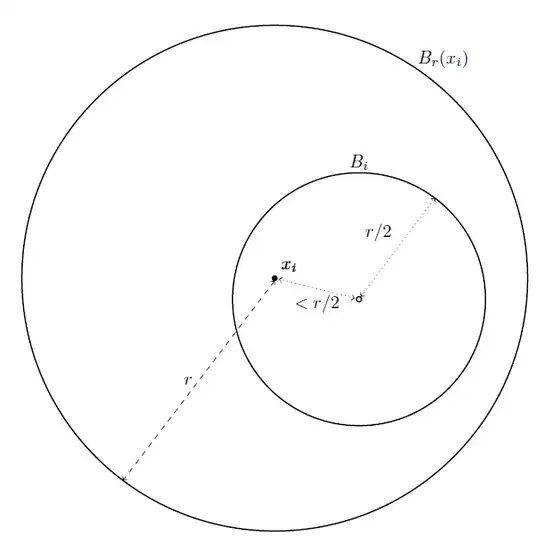

Proof. Given $r$, consider some minimal cover which obtains $N'(r/2)$:
$$\displaystyle K \subset \bigcup_{i=1}^{N'(r/2)} B_i,$$
where the $B_i$ are balls of radius $r/2$ whose centres needn't lie in $K$.
Then, since the cover is minimal, each $B_i$ must meet $K$, i.e. for each $i$ there is some point $x_i \in B_i\cap K$.
Now, since the distance from $x_i$ to the centre of $B_i$ is less than $r/2$ (as $x_i \in B_i$), every point in $B_i$ is less than $r$ away from $x_i$ (via triangle inequality if you like).
One ball sits inside the other
This gives the inclusion
$$ B_i \subset \mathbb B(x_i,r) := \{y \in \mathbb R^n : \|x - y\|<r\};$$
and consequently,
$$ K \subset \bigcup_{i=1}^{N'(r/2)} B_i \subset \bigcup_{i=1}^{N'(r/2)} \mathbb B(x_i,r) $$
so this gives you a cover of $K$ by $N'(r/2)$ balls of radius $r$, centred at points in $K$.
