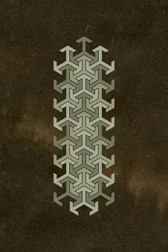

In my spare time, I'm playing a lot with a series of patterns which use a hexagonal grid, and a tessellating design I saw on a chair in my dentist's surgery.

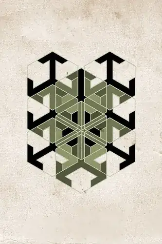

Here's some examples of patterns I've worked up...
Because I don't really understand the math, I've had to create the basic unit shape by hand, I can see the 60/120 degree angles well enough, but I really want to figure out the proportions of the shape, which appear (from just looking) to be tightly interrelated.

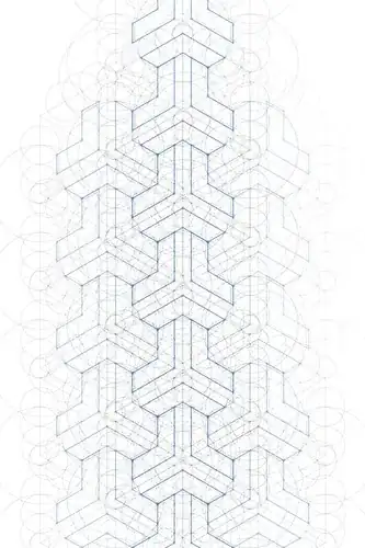

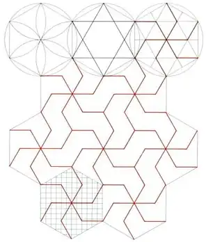

It seems that using circle construction of a grid of equilateral triangles, this pattern can be discovered, along with numerous variations, eg:
Hex tile constructed from triangle grid
Circles to equilateral triangle grid, to repeating pattern discovery

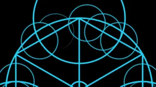

Animated Construction
Hexagonal Tessellation Construction (draft) from ocodo on Vimeo.
Click the image to watch...

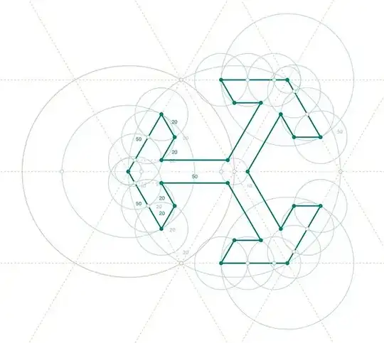

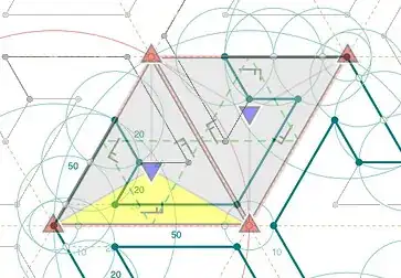

So I discovered through pencil/compass construction that the base unit is 1/8th of the radius of the initial construction circle (i.e. the length of one side of the hexagon.)
The width of the struts are 1/4 (or 2 base units)
I'm pushed for time to get this done tonight so I'm just posting progress as I work things out... (and noting where I make mistakes)
Construction:
construction grid

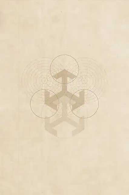

Here is the construction mapped to the the 31m wallpaper group...
(handily iPhone4 wallpaper sized... well, the link through is.)

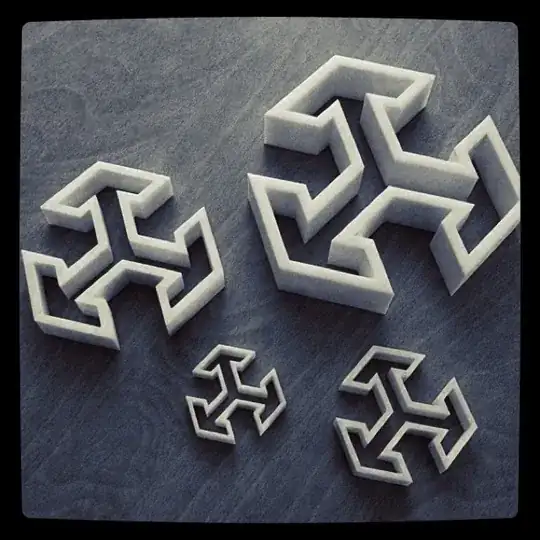

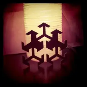

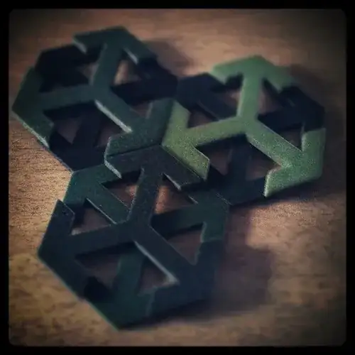

I have these shapes being 3D printed, I'll post a report when I get them in the mail (will be about 10 days) (I used Shapeways.com who print 3D objects in plastic, metal and other assorted materials.)
The intention with this set of 7 is to assemble them, and frame them nicely. I also get to test the precision of the 3D print material.
3D prints arrive.
Due to my inexperience with solid manufacture, I completely overlooked the need to allow for manufacturing/material tolerance. After a brief study on this aspect I'm remodelling my figures to add this in. However I need to fabricate a few sets to test optimal tolerance.
Anyway, this is what I've got back from shapeways, (nb: they use UPS shipping, included in the cost and the items are packaged very well, there is no risk of breakage.)
When I get the tolerance right I'll post again.

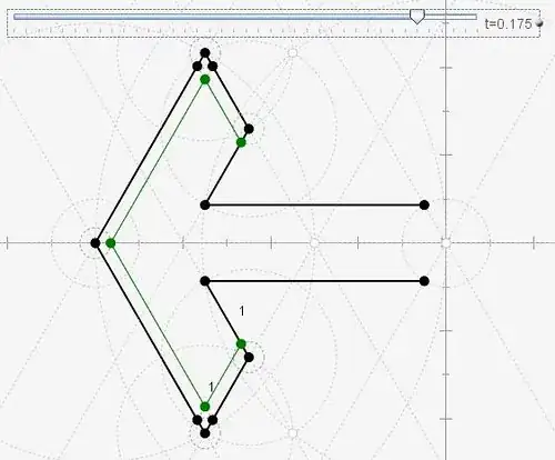

By the way, I found a very cool feature in CARMetal, (the software I've used to do the geometric construction.) I can add controls like sliders and text inputs that affect dimensions. For example, I create a slider t (tolerance) and can then apply t to the radius of my tolerance circles, which I use subsequently to construct the line segments which make up the adjusted shape, these all stay in sync with the slider value.
It's probably easier to see it, the tolerance is marked green (way too much in this example.)

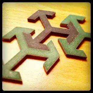

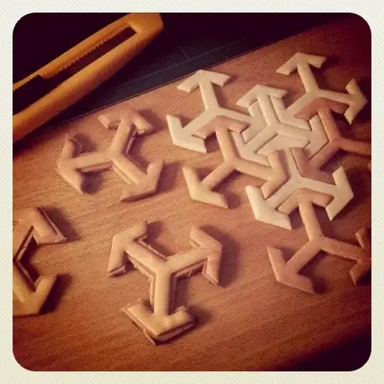

Clay tiles...
Tiles made with Sculpey medium
Well, not actually clay, I've used Sculpey, and pressed the tiles out using these tile cutters, which were 3D printed by Shapeways.

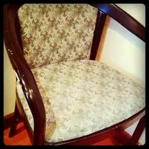

I also took a photo of the chair in my dentists surgery, which began this little study of mine.

  • @Qiaochu, the 60∘ (120∘) stuff, was quite obvious to me, however the bit that I found very tricky, I've managed to discover by doing construction on paper. It turns out the primary unit (eg. in the widths of the struts.) is based on 1/8 of the length of a side of the hexagon.
    The actual strut widths are 1/4 (or 2 units.)
    So if I construct the initial hexagon using a size easily divisible by 8, then I have a much easier time building it.
