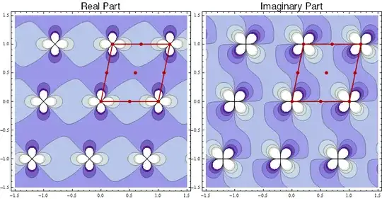

Intuitively, a "typical" elliptic function should have p1 symmetry. For example, the following plots show the function $\wp\,'(z)$ for the lattice generated by $1$ and $0.2+i$.
(Note: In this picture and all of the subsequent pictures, dark blue indicates negative values and light blue indicates positive values, while the white regions show the placement of the vertical asymptotes. All of these contour plots were produced in Mathematica.)

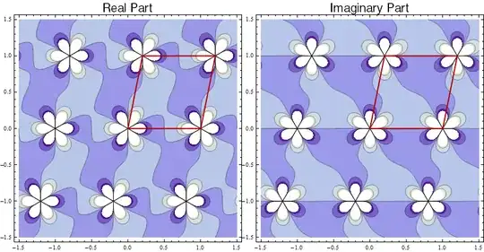

Interestingly, the Weierstrass $\wp$-function always has p2 symmetry. The following plots show the function $\wp(z)$ for the lattice generated by $1$ and $0.2+i$.
(There is $180^\circ$ symmetry around each of the marked points.)
More generally, let $G$ be the p2 group consisting of the translations together with $180^\circ$ rotations at every point of the lattice generated by the half-periods, including the origin. Then I would conjecture that an elliptic function will be invariant under the action of $G$ if and only if it can be expressed as a rational function of $\wp(z)$ alone (without involving $\wp\,'(z)$).

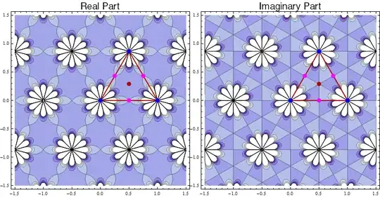

This appears to be the symmetry of the Dixon elliptic functions. However, it is not hard to make an elliptic function with p3 symmetry directly from Weierstrass $\wp$-functions. Using the lattice generated by $1$ and $e^{i\pi/3}$, the function $\wp\,'(z)$ has p3 symmetry:
(There is $120^\circ$ symmetry around each of the marked points.)
More generally, let $G$ be the p3 symmetry group of the function above. Then I would conjecture that an elliptic function for this lattice is invariant under $G$ if and only if it can be represented as a rational function of $\wp\,'(z)$. (Note that this includes the Dixon function $\mathrm{cm}(z)$, but that $\mathrm{sm}(z)$ is invariant under a translate of $G$.) Then every elliptic function with p3 symmetry would be obtained from these via translation.

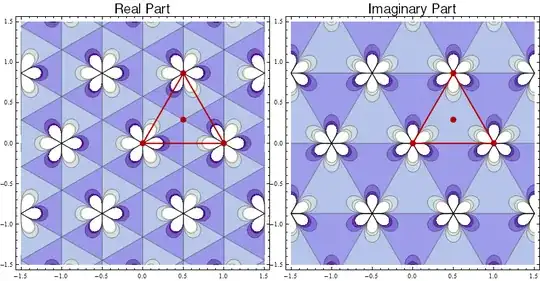

Again, it isn't too hard to make an elliptic function with p6 symmetry. We simply use $\wp\,'(z)^2$ for a hexagonal lattice:
(There is $60^\circ$ symmetry around the blue points, $120^\circ$ symmetry around the red point, and $180^\circ$ symmetry around the purple points.)
Again, it seems that $\wp\,'(z)^2$ "generates" the elliptic functions with p6 symmetry, in the sense that every elliptic function with p6 symmetry is a translate of a rational function of $\wp\,'(z)^2$.
