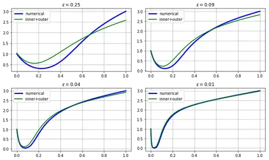

Illustration of the solution above: A numerical solution of the boundary value problem is plotted against the approximation to show that indeed the 3 parts do fit together that way for sufficiently small $ε$, visually for $ε<0.05$.
