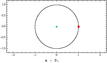

As far as the Julia set goes, Lubin is correct that the sequence of full inverse images converges to the Julia set. While $F_{a}$ is just a single branch of the inverse, we'd still expect iteration of $F_{a}$ to generate a sequence of points that converges to some point on the Julia set. This is illustrated in the animation below. The origin is the green point and the fixed limit is the red. The blue points represent the sequence of iterates of $F_a$ starting from the green and ending at the red.
