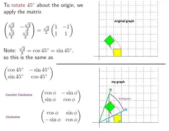

  1. How does $ {\sqrt 2 \over 2} = \cos (45^\circ)$?
  2. Is my graph (the one underneath the original) accurate with how I've depicted the representation of the triangle that the trig function represent? What I mean is, the blue triangle is the pre-rotated block, the green is the post-rotated block, and the purple is the rotated change ($45^\circ$) between them.
  3. How do these trig functions in this matrix represent a clockwise rotation? (Like, why does "$-\sin \theta $ " in the bottom left mean clockwise rotation... and "$- \sin \theta $ " in the upper right mean counter clockwise? Why not "$-\cos \theta $ "? $$\begin{bmatrix}\cos \theta &\sin \theta \\-\sin \theta & \cos \theta \end{bmatrix}$$
Any help in understanding the trig representations of a rotation would be extremely helpful! Thanks

    For the third question: If you believe that the matrix for counter clockwise rotation is correct, then to obtain the clockwise matrix, just replace $\phi$ by $-\phi$. Rules of trigonometry will then tell you that $\cos -\phi = \cos \phi$ and $\sin -\phi = -\sin \phi$, leading to the clockwise matrix you have. – TMM Apr 16 '13 at 19:50

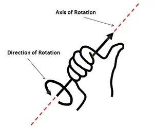

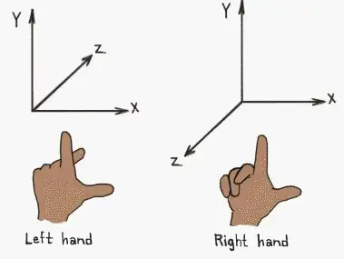

When it comes to rotating clock- or counterclockwise you can always use the left or right hand rule:
  1. Use your right or left hand to determine the axes:
  1. See which way is clock- and which way is counterclockwise. In the image below the four finger tips that go straight into your palm always point along the direction of rotation (right hand rule):
Once you pick one of the two hands stick with it and use it until the end of the specific task otherwise the results will probably end up screwed up. Notice also that this rule can also be applied to 2D. Just remove (but not cut off) the finger that points along the z axis (or whichever dimension of the three you don't need) and do your thing.

  • This is very helpful, one question though about the direction of rotation: in the image with the hand and the axis of rotation the finger tips always point into the direction of rotation (in a right handed coordinate system) and this is counter-clockwise, isn't it? – Alexander Apr 02 '20 at 08:06
  • No, the four tips show to clockwise rotation. Sadly the image is not displaying that circular arrow in a manner that is easy to understand. I would have chosen a different color for the axis arrow so that it's easier to see how it overlaps the one for the rotation direction. – rbaleksandar Apr 02 '20 at 08:17
  • Ah, OK, I should have defined from which direction one looks onto the fingers as well. To connect the dots: the way you define the 2D rotation matrix (positive $R(\theta)$) we rotate in the same direction as the finger tips (which is clockwise looking along positive Z). – Alexander Apr 02 '20 at 13:08
  • I haven't done a lot of math in a while so I might be wrong but I think it was counterclockwise.Draw a right hand coord. sys on a piece of paper - x points to the right and y to the upper border of the sheet.Add to that a circle with the center of the coord system also being its center.Write down some angles - 0, 45, 90 etc.Your z will be "sticking" out of the plane towards you (since x is index and y is middle finger) from the center of the circle.Now if you rotate clockwise using the matrix the x will go towards the lower border, while the y - towards the right border: 0, 45, 90 etc degrees. – rbaleksandar Apr 02 '20 at 16:57
  • However if you view it from the perspective of a hand your finger tips will be rotating in the opposite direction (outwards of your palm), which is counterclockwise. – rbaleksandar Apr 02 '20 at 16:57
  • Perfect, I think we agree here. To your first comment: yes, counterclockwise. Second comment: yes, counterclockwise as in your last picture. And then also $R(\theta)$ counterclockwise, which in the answer is written as clockwise but in your comment counterclockwise. – Alexander Apr 02 '20 at 18:21
  • Feel free do edit so that answer is more accurate. :) – rbaleksandar Apr 03 '20 at 03:22
  • I would still not remove the "tips point to the clockwise rotation" since it is true. :) It just depends which coordinate system you are using. Combining left hand rule with a right handed coordinate system doesn't make much sense. :D – rbaleksandar Apr 03 '20 at 13:44

All of the trigonometry will be clear if you examine what happens to the points $(1,0)$ and $(0,1)$ under these transformations. After they have moved, drop a perpendicular vertically and a line through the origin and consider the triangle formed. They will be (sometimes degenerate) triangles with hypotenuese 1 and then you will see why each of their legs has measure $\sin(\phi)$ or $\cos(\phi)$ etc.
Here's what I mean: after a $\pi/6$ rotation counterclockwise, the point $(1,0)$ has moved to $(\sqrt{3}/2,1/2)$. This point, in addition to $(0,0)$ and the point directly below it on the $x$ axis, $(\sqrt{3}/2,0$ form a right triangle with hypoteneuse $1$. Look at lengths of the short sides of the triangle. Try to do the same thing with an angle $\phi$ between 0 and $\pi/2$, and analyze what the sides of the triangle have to be in terms of $\sin(\phi)$ and $\cos(\phi)$.
Because a rotation in the plane is totally determined by how it moves points on the unit circle, this is all you have to understand.
You don't actually need a representation for both clockwise and counterclockwise. You can use the counterclockwise one all the time, if you agree that a clockwise rotation would be a negative counterclockwise rotation. That is, if you want to perform a clockwise rotation of $\pi/4$ radians, then you should use $\phi=-\pi/4$ in the counterclockwise rotation representation.
The fact that $\sin(-\phi)=-\sin(\phi)$ accounts for the change in the sign of sine between the two representations, and the fact that the $\cos(\phi)$ doesn't change is because $\cos(-\phi)=\cos(\phi)$. You may as well just pick the counterclockwise representation scheme, and perform both clockwise and counterclockwise rotations with it.

  • drop a perpendicular vertically and consider the triangle formed - what does this mean? and Because a rotation in the plane is totally determined by how it moves points on the unit circle, this is all you have to understand. do you think you can diagram this point out? – user3871 Apr 16 '13 at 19:38
    @Growler I wish I knew how to do pictures well on here! I'll clarify my explanation and include an example asap. – rschwieb Apr 16 '13 at 19:40
  • I guess you could do it in paint or some other tool then append the picture to your answer? – user3871 Apr 16 '13 at 19:41
    @Growler OK, I finished adding a bit. Let me know if I should say more. I think you'll be able to draw it based on that. – rschwieb Apr 16 '13 at 19:45
