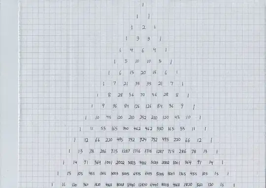

This is called Pascal's Triangle. The triangular numbers are the third diagonal (first is all ones). The cumulative sums are in the fourth diagonal.
Also see the answer by Yves at Triangular numbers and pascal's trangle
