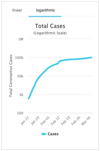

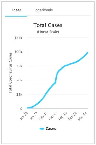

...essentially, why would someone want to look at a logarithmic scale graph? What can be derived from a logarithmic scale graph that makes it worthy of presentation in addition to a linear scale version?
At worldometer on Coronavirus there is a graph in "linear scale" (the default) and a tab with a "logarithmic" scale version.
Here they are:

    a) So that the data points are not squashed up one end when there are a few outliers, b) Because the properties being plotted have a logarithmic relationship. c) Consider a radar screen. When objects are close, their exact distance is much more important than objects further away, so a logarithmic scale is useful here. – Weather Vane Mar 06 '20 at 18:29
    Almost by definition it is useful for anything that increasing exponentially. For example population growth. The world's population has gone from from $3$ to $7$ and a half billion in about $40$ years wheras in the forty years before it had only gone from $2$ to $3$. and it took nearly $50$ years to get from $1$ billion to $2$ billion and it took thousands of years to get to $1$ billion. Diseases would normally be a good case for logarithmic scales, but so far the corona virus has been pretty linear. – fleablood Mar 06 '20 at 18:47
  • I suppose that so far the answer that most does it for me comes from Intuitive use of logarithms: "plotting (if your scale gets too large)"... though I don't see it being a problem with the current linear graph. Also, the linear graph gives a superior impression of trajectory; the logarithmic curve gives the impression of it slowing down. – user664833 Mar 06 '20 at 23:27
