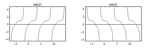

Plots of the Dixon functions on the real line don't look very interesting:
Dixon elliptic functions, real line

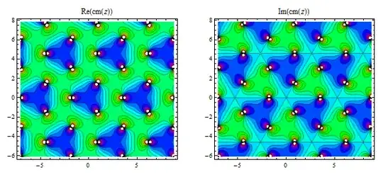

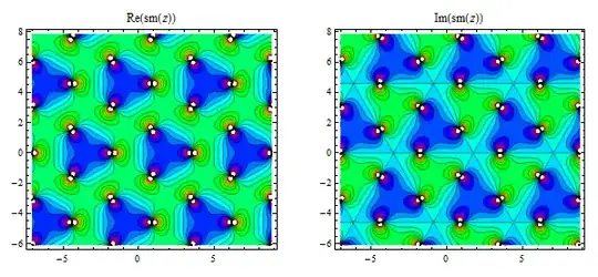

but, as with the usual elliptic functions, the fun starts in the complex plane:
Dixon sm Dixon cm

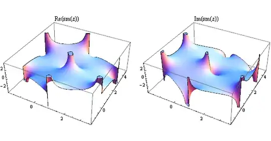

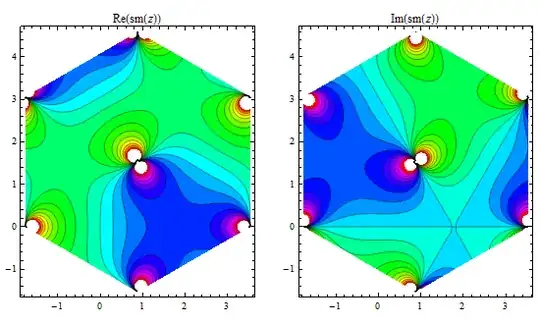

These contour plots clearly display the hexagonal structure of the Dixon functions. Here is a single "fundamental period hexagon" for $\operatorname{sm}(z)$:
period hexagon for sm(z), contour plot period hexagon for sm(z), 3D
Note that a section of the real line (in the plots above, $\left(-\frac{\pi_3}3,\frac{2\pi_3}{3}\right)$) corresponds to a chord of the period hexagon.
Both Dixon elliptic functions possess three poles (once you've identified the congruent poles in the period hexagon) and three zeros within the fundamental hexagon. Of course, one could go the usual route and consider the "repeating unit" of the Dixon function to be a particular rhombus; this is equivalent; since the rhombus can be appropriately dissected into a regular hexagon, and vice-versa.
