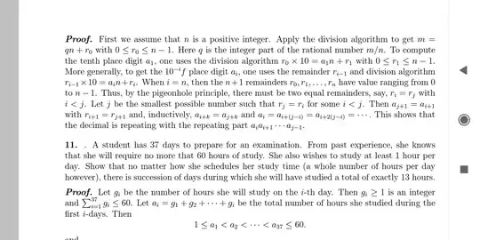

I could not think about how to prove that decimal expansion of a rational number of a rational number is eventually repeating.
Note that this question has to be proved using Pigeonhole principle only. So, don't close it.
While searching on internet I found this solution whose image I am posting. enter image description here
But I am unable to think about how does author writes this in third line of proof ->To compute the 10 place digit $a_1$ one computes $r_0$ ×10 = $a_1$ × n +$r_1$ .
Can someone please give explanation of this statement that why this must be true.

  • @jean Marie I am asking for problems in this proof which is given in picture. –  Feb 19 '20 at 07:01
If you are struggling to understand some abstract statement first consider a concrete example.
For instance, set $m=17,n=7$. Then $\frac{m}{n}=\frac{17}{7}=2.428571428571...$.
So by division algorithm, you get $17=2\cdot7+3$. You can observe $2$ is the integer part and $3/7$ is the fractional part which is equal to $0.42857142857... $
what is the tenth place digit it is $4$ right? what is it? it is the integer part of $10* 0.42857142857... $ or in other words it is the integer part of $\frac{3\cdot10}{7}$
To get the integer part you multiply $3$ by $10$ an apply division algorithm. which gives you $30=4\cdot7+2$. You can proceed in this manner to get any $10^{-i}$th place digit.
Edit: Suppose $r_i=r_j$ for some $i\lt j$. Also, you know that $0\leq r_i \leq n-1$
Then by division algorithm you can find unique integers $a_{i+1},r_{i+1}$ where $0\leq r_{i+1} \leq n-1$ s.t $10\cdot r_i=a_{i+1}\cdot n+r_{i+1}$.
It follows from the uniqueness that $a_{i+1}=a_{j+1},r_{i+1}=r_{j+1}$

With
$$m = qn + r_0 \tag{1}\label{eq1A}$$
you get
$$\frac{m}{n} = q + \frac{r_0}{n} \tag{2}\label{eq2A}$$
As stated, $q$ is the integer part. Also, $\frac{r_0}{n}$ is the fractional part. In base $10$, if $a_1$ is the first decimal digit, it would be
$$\frac{r_0}{n} = 0.a_1... = \frac{a_1}{10} + r_2 \tag{3}\label{eq3A}$$
where "$\ldots$" are the following digits and
$$0 \le r_2 \lt 0.1 \tag{4}\label{eq4A}$$
To get the $a_1$ as the integer part of an expression, you can multiply both sides of \eqref{eq3A} by $10n$ to get
$$10(r_0) = a_1 n + 10n(r_2) \tag{5}\label{eq5A}$$
You have here that $r_1 = 10n(r_2)$. From \eqref{eq4A}, you get $0 \le r_1 \lt 0.1(10n) = n$. Since $r_1$ must be an integer, this becomes $0 \le r_1 \le n - 1$, as stated in the image.

By division theorem there are $m = qn + r_0$ where $0\le r_0 < n$.
So $\frac mn = q + \frac {r_0}n$.
Now consider the number the number $K = 10r_0$. As $0 \le r_0 < n$ then $0 \le 10r_0 = K < 10n$.
So be division theorem there are $a_1$ and $r_1$ where $K= a_1n + r_1$ where $0 \le r_1 < n$. But notice that $K < 10n$ so $\frac Kn < 10$ so $a_1 < n$ so $a_1 = 0......9$.
So $K = 10r_0 = a_1n + r_1$.
And $m = qn + r_0 = qn + \frac {10r_0}{10} = qn + \frac {a_1n + r_1}{10}$.
So $\frac mn = q +\frac {a_1 + \frac {r_1}n}{10}=$
$q + \frac {a_1}{10} + \frac {r_1}{10n}$.
And as $q_1 = 0......9$ then $\frac {a_1}{10} = 0.a_1$
and $\frac mn = q.a_1 + \frac {r_1}{10n}$.
A concrete example:
Consider $\frac mn = \frac{596}{73}$ (two number off the top of why head).
Now we want $596= q*73 + r_0$ and we get that by
$m = 596 = 8*73 + 12$ where $12 = r_0$ is the remainder.
So $\frac mn = \frac{596}{73} = 8 + \frac {12}{73}$.
Well, there's nothing in the world to stop us from wondering what $10r_0 = 120$ is like. It might not be clear why we wonder but ... we can wonder.
We want $10r_0 = 120 = 73a_1 + r_1$.
What that is solved by
$530 = 73*1 + 47$ where $a_1 = 1$ and $r_1 = 47$.
But what does that mean?
$\frac mn = 8 + \frac{12}{73}=8 + \frac {120}{73*10}$
$=8 + \frac {73*1+47}{73*10}= 8+\frac {73*1}{73*10} +\frac {47}{73*10}$
$=8 + \frac 1{10} + \frac {47}{73*10}=8.1 + \frac {47}{73*10}$.
And that $1 = a_1$ serves as our first decimal.
fleablood
