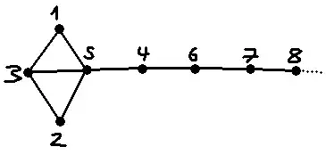

Interestingly, cographs are also characterized by the property of not having a $P_4$ (path on 4 vertices) as an induced subgraph, and indeed any class of graphs that includes the $P_4$ graph is not carefully reducible. However, there are actually carefully reducible graph classes that do contain non-cographs:
Let $G$ be the infinite graph pictured above. Consider the class $C$ of graphs defined as the class of all subgraphs $G_n$ induced from $G$ by the vertices $1 \ldots n$, and let $P(G_n) = n$. Now in this case it is easy to verify that any isomorphism of $G_{n-1}$ extends to an isomorphism of $G_n$. So $C$ is indeed carefully reducible, but $G_n$ is not a cograph for all $n > 5$.
