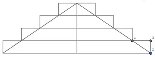

Let's say we have the following picture after constructing the triangle... The large triangle has height $r$ and base $2\pi r$. enter image description here
If we have $n$ rectangles, then as in the figure, the error in our approximation will be $n\times \triangle CGE$. All the small triangles will have the same area as their heights are equal and their bases are proportional to their heights.
Now, the height of this small triangle is $CG=\dfrac{r}{n}$. The base, $GE$ can be found using proportionality, which is $GE=\pi \cdot CG$, which gives $GE=\pi\dfrac{r}{n}$.
So the total error is $n\times\frac{1}{2}\times\dfrac{\pi r}{n}\times\dfrac{r}{n}=\dfrac{\pi r^2}{2n}$.
Now as you've already realized, if we increase $n$, we decrease the error. In calculus, this $n$ is taken to be approaching infinity. As a result, the error approaches a perfect zero. In limit notation,
$\displaystyle \lim_{n \to \infty} \dfrac{\pi r^2}{2n}$
which is just $0$. Thus, the area of the triangle precisely equals that of the circle only when we take the limit $n \to \infty$.
