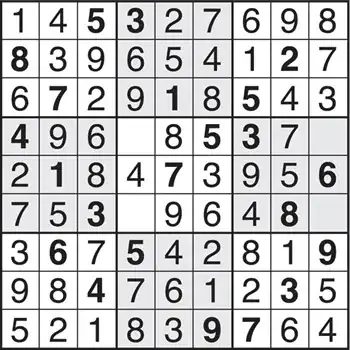

I conclude that the largest number of starting clues for any Sudoku to be ambiguous is 77 (81 - 4), and you can construct it by finding a 'rectangle' with ones on two opposite corners and twos on the other two opposite corners. Remove all four of them. Now you can solve it in two ways: it is ambiguous.
A random Sudoku from the Internet:
8
77.
