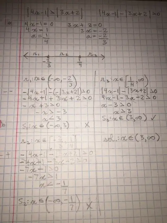

I have finals in a couple of days. I need help with inequalities. I have spent around 15 hours trying my hand at inequalities and I am still trying to figure things out. In this case I need help with an inequality with two absolute values with greater than symbol.
The following is a picture of the inequality ($|4x-1|>|3x+2|$) and the procedure I tried, which is something I applied from an answer by Isaac to another question in this site, although I think I did something wrong because it looks like I got the answer wrong or incomplete.
Please tell me what I did wrong and how to do it the right way.
Thanks in advance.
PS: Does this method also apply if there is a less than sign?
possible wrong procedure of inequality with two absolute values

You're doing almost everything right; you're just misinterpreting the results at the end.
In particular, the idea is to combine intervals where the inequality holds. In the first region, $\left(-\infty, -\frac23\right)$, you arrived at $x<3$. It seems that you rejected this result, judging by the "$\times$" beside your work. This is where you went wrong.
Instead, think of it like this:
Within the region $\left(-\infty, -\frac23\right)$, which $x$ satisfy $x<3$?
All $x$ do within this region. Another way to see this is that you are effectively taking the intersection of the two: $$\left(-\infty, -\frac23\right) \cap (-\infty,3) = \left(-\infty, -\frac23\right)$$
The other two regions are handled the same way.

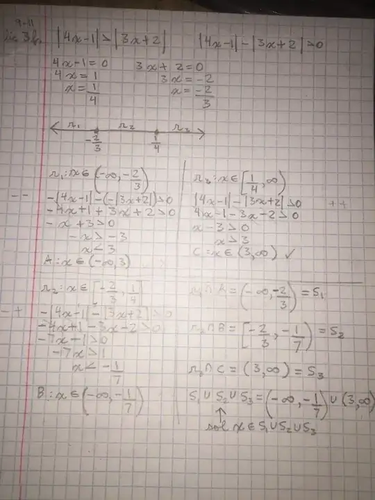

I tried again, following the answer of Théophile, and I was able to reach the correct solution. Below is the pic of the procedure I used. Thanks!
solved inequality
