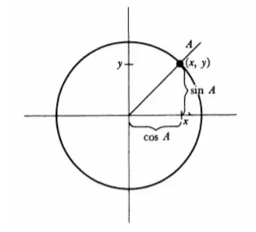

We define two functions called sine and cosine for all real number angle measures using the unit circle. We look at where the line formed by some chosen angle intersects the unit circle; the $x$-coordinate is defined to be the cosine of that angle, and the $y$-coordinate to be the sine:
Notice that the right triangle definitions for acute angles are just special cases of the broader unit circle definition (even though you might not have known that when you first learned about sine and cosine).
All the remaining trig functions other than sine and cosine can be defined in terms of those two functions.
