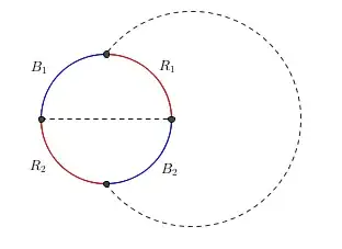

Proof of a counterexample when $S$ is uncountable. Using the complex plane, let $S=\{\{e^{i\theta}, e^{i(\theta+\pi)}\}~|~\theta \in [0,\pi) \}$.
Suppose $\mathcal{F}$ is a set of simple curves that satisfy the hypothesis.
  1. By hypothesis, if two curves intersect, then the point of intersection is an endpoint for one of the curves.
  2. There are at most two curves which only intersect the circle at endpoints. All other curves must cross the circle at least once. This has been modelled in following image:
I'll assume this model but it can also be proven when there are only $0$ or $1$ which don't cross the circle. Without loss of generality, there are uncountably many curves $\mathcal{F}_1$ that join "red points" and cross $B_1$. Similarly, for these points of intersections, $I \subset B_1$, let $\mathcal{F}_2$ be set of uncountable curves that join them to $B_2$ and crossing $R_2$ (without loss of generality again).
$\mathcal{F}' = \mathcal{F}_1 \cup \mathcal{F}_2$.
By intermediate value theorem, the curves in $\mathcal{F}'$ cross the $x$-axis. For each point $p \in I$, there are two distinct point, $x_1$ and $x_2$, corresponding points on the $x$-axis (one for a curve in $\mathcal{F}_1$ and another for $\mathcal{F}_2$). Since the curves don't cross, there is no other intersection point between $x_1$ and $x_2$. Let $x_p$ be the midpoint of $x_1$ and $x_2$. This forms a bijection between $x_p$ and $p$. Each $x_p$ is isolated and any set of isolated points is countable.$^1$ This is a contradiction as there is also bijection from each function in $\mathcal{F}_1$ to a given $p$.
Therefore, no such $\mathcal{F}$ exists for the given $S$.
$^1$ One of the interesting theorems I proved in my earlier investigations. Glad I could finally use it somewhere.
