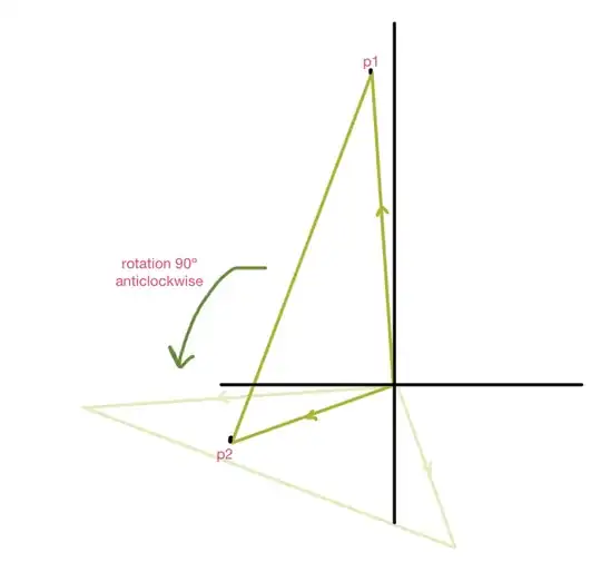

At this point, you can either wave your hands while saying something about rotation matrices having determinant 1, or you can repeat the argument for a general $\binom{x_2}{y_2}$. What does it mean to pick 3 points in counterclockwise order? It means that the third point is on the "left" side of the line joining the first two points. Since the first point is $\binom{0}{0}$, a vector parallel to this line is $\binom{x_2}{y_2}$, and the vector $$ \binom{-y_2}{x_2}$$ is the $90º$ anti-clockwise rotation of $\binom{x_2}{y_2}$. The third point $\binom{x_3}{y_3}$ is on the "left" side of the line iff the dot product of $\binom{x_3}{y_3}$ and $ \binom{-y_2}{x_2}$ is positive, whence the result. (in fact, I might take this as a definition of being on the "left" side...)
