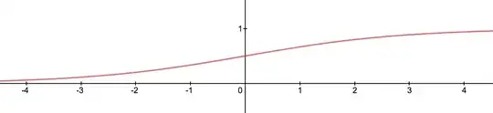

To make things simple, a suitable function is $F(x) = \frac{2^x}{1 + 2^x}$. (This is similar to the standard logistic function, but with base $2$ instead of base $e$.)
Now, if the number you look at is $x$, you say "higher" with probability $F(x)$, and "lower" with probability $1-F(x)$. For instance, if you turn over a card and see the number $3$, you say "higher" with probability $F(3) = \frac{2^3}{1+2^3} = \frac89$, and "lower" with probability $1 – F(3) = \frac19$.
