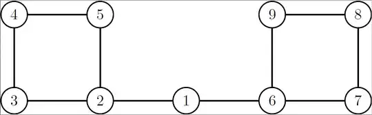

An example: An example graph.
A walk (in this case closed) would be $1-2-3-4-5-2-3-4-5-2-1$.
A trail would be $1-2-3-4-5-2$.
A path would be $4-3-2-1-6-9-8$.
