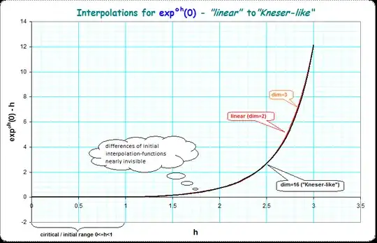

Here I have some plots for the family of interpolation-ansatzes, plotting $g_{s}(0,h)$ with sizes $s=2 \dots 16$ and $h=0 \cdots 1$ and by functional equation $\exp(g_s(0,h))$ and $\exp^{\circ 2} (g_s(0,h))$ .
To make the differences better visible I use $g_s(0,h)-h$ instead. The unit-interval of the linear interpolation ($s=2$) lies then on the unit-interval of the x-axis in the coordinates-system. We see then also its edgyness and the improved smothnesses of the larger-size interpolations.
Note, that for my own documentation I also inserted the term "Kneser-like" because it seems, that process of increasing the matrix-size runs towards the Kneser's solution, as I've documented elsewhere. Also in the picture I use 'dim' instead of 'size')

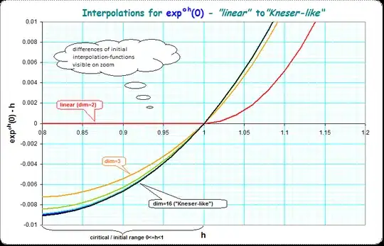

The differences seem even be neglectable, so the charme of the linear interpolation can easily be explained. But I find the edgyness a serious problem, and if we zoom inside the critical regions at $h \approx 1$ and $h \approx 2$ we see this a bit more:
Now the general difference between the interpolations using different matrix-sizes becomes visible. The red curve, for the linear interpolation shows a sharp edge, while the interpolations with higher orders edges are not visible.

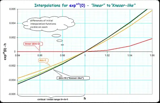

I have a slightly stronger zoom here:
(the corners at $0.02$ steps are due to the resolution of my plot in that granularity)

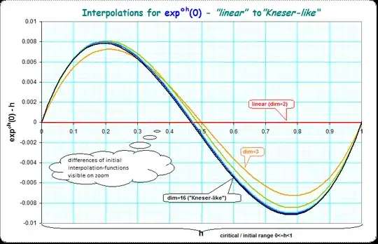

In general the curves in the initiating interval $h=0 \dots 1$ are sinusoidal deviations from the linear shape, see this zoom

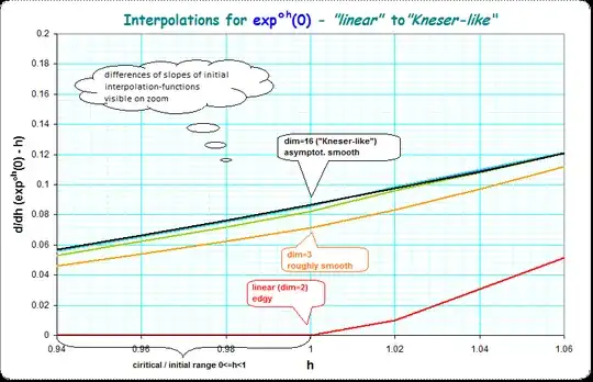

and more on the edginess a picture showing the first derivatives of the previous curves
