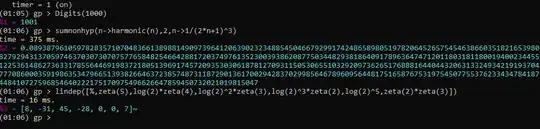

Considering that Euler-Zagier Sum has weight 2 + 3 = 5, result is a linear combination of $log(2)^k\zeta(m)\zeta(n)$ such that $k,m,n$ are non-negative integers (factor is omitted if any of them is 0) and $k+m+n=5$, (note that log(2) plays the role of "$\zeta(1)$"), we use Pari/GP v2.14 to get the following output
and voilá.
