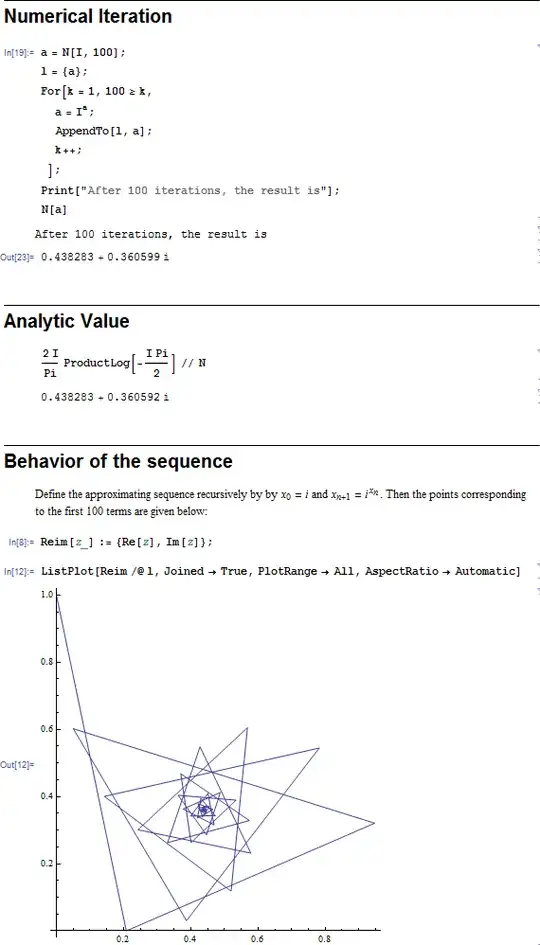

Here is a numerical result supporting Fabian's argument.
Here, the complex logarithm
$$ z^{w} := \exp (w \operatorname{Log} z) $$
is defined via the principal value $\mathrm{Log}$ of the logarithm, defined on $\Bbb{C} \setminus (-\infty, 0]$.
Sangchul Lee
  • 181,930
  • Can you share a Mathematica Notebook? – m0nhawk Mar 21 '13 at 10:54
  • @m0nhawk, I'm sorry, but I did not save it :( Fortunately, the code is short and you can resurrect it by just re-typing it. – Sangchul Lee Mar 21 '13 at 10:56
    @monhawk: maybe this belongs more to Mathematica.SE but the first part (Numerical Iteration) can be made much faster by using iter=100;l = NestList[Power[I, #] &, N[I], iter]; Print["After ", iter," iterations, the result is: ", Last@l];. – Fabian Mar 21 '13 at 11:14
  • @Fabian, that's a nice method! Thank you. – Sangchul Lee Mar 21 '13 at 11:17

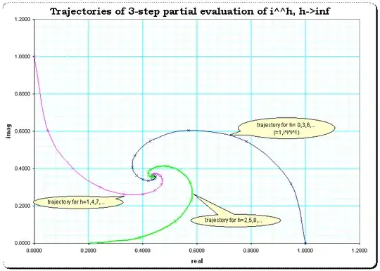

This is rather another comment than an answer but contains a picture, so...
If we display the 3-step-like trajectory separated into 3 single trajectories, we get an improvement of imagination of the convergence. See this one enter image description here
Similar improvements can be made with other bases. The idea is, to use this for convergence-acceleration procedures like Euler-sums and similar.

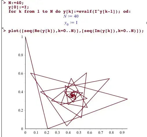

Here is the Maple version of the graph from sos440...
MAPLE
GEdgar
  • 117,296
