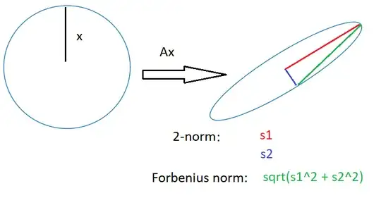

The 2-norm (spectral norm) of a matrix is the greatest distortion of the unit circle/sphere/hyper-sphere. It corresponds to the largest singular value (or |eigenvalue| if the matrix is symmetric/hermitian).
The Forbenius norm is the "diagonal" between all the singular values.
i.e. $$||A||_2 = s_1 \;\;,\;\;||A||_F = \sqrt{s_1^2 +s_2^2 + ... + s_r^2}$$
(r being the rank of A).
Here's a 2D version of it: $x$ is any vector on the unit circle. $Ax$ is the deformation of all those vectors. The length of the red line is the 2-norm (biggest singular value). And the length of the green line is the Forbenius norm (diagonal). enter image description here
  • 23
    I'm a simple man. When I see a geometric explanation, I upvote. – D_Serg Apr 07 '20 at 15:13
    Geometric is just like an underrated actor in Bollywood, who can act really well but doesn't get enough exposure. – Laveena May 14 '23 at 17:56
  • [Clapping.] 2-norm looks in the most important direction, Frobenius looks in all directions (which is wiser). – Oskar Limka Oct 03 '23 at 09:25
  • @OskarLimka what do you mean by most important direction vs all directions? – nullspace Dec 29 '23 at 16:39
  • @nullspace 2-norm quantifies the direction and intensity of maximal stretching, Frobenius quantifies the square-mean of stretching over all directions. – Oskar Limka Jan 01 '24 at 20:28
