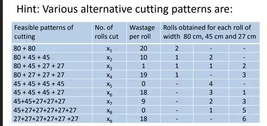

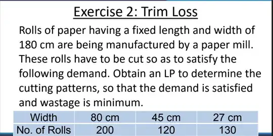

I was going through the following optimization problem: enter image description here Also there was a hint with this problem as: enter image description here
Above are listed nine alternative ways to cut the paper. Clearly the wastage per roll is always less than $27$, because if we get $30$ cm as wastage then that means that we can still get a roll of $27$ cm and so the wastage is $3$. This one thing is clear to me. Is there any method by which I can get that total number of alternatives are nine OR I have to do it manually?
What I have done:
Out of $180$ cm roll we can get $0,1$ or $2$ rolls of $80$ cm, for $45$ cm roll we have options $0,1,2,3$ or $4$ and for $27$ cm roll we have options $0,1,2,3,4,5$ or $6$. From this information maximum number of combinations would be $3\times 5 \times 7=105$. Here I was unable to use the information that the wastage will be less than $27$ cm.
Next I listed all the possibilities as triplets:
$(0,0,0),(0,0,1),(0,0,2),....,(0,0,7)$
$(0,1,0),(0,1,1),(0,1,2),....,(0,1,7)$
$(0,4,0),(0,4,1),(0,4,2),....,(0,4,7)$
$(1,0,0),(1,0,1),(1,0,2),....,(1,0,7)$
$(2,4,0),(2,4,1),(2,4,2),....,(2,4,7)$
So now we have $15$ rows in total. And from each row at most we have only one entry which is suitable for us. Because if in a row we have $(a,b,c)$ as a suitable entry then that means that $(a,b,c-1)$ will give a wastage of more than $27$ cm so its not good for us and $(a,b,c+1)$ is not possible because $(a,b,c)$ has wastage less than $27$ cm. So we have $15$ rows so at most we have $15$ combinations which is suitable for us.
The last $5$ rows, rows with first entry as $2$. Out of all these we have only $(2,0,0)$ suitable for us. So out of last $5$ rows we have only one entry $(2,0,0)$ which is suitable for us. So now for the first $10$ rows we have at most $10$ suitable combinations and one from the last $5$ rows. Total will be maximum $10+1=11$.

  • You basically are trying to solve $80a+45b+27c+180$ where $a,b,c$ are nonnegative integers. This is a linear Diophantine equations in $3$ variables: this question is similar. – Toby Mak Jul 29 '19 at 08:23
    Just adding a comment for those who haven’t seen this type of problem before. It is the cutting stock problem, and the classical approach to solve it efficiently is to use column generation, whereby the combinations are generated dynamically as needed via a subproblem. In this case, the subproblem is a knapsack problem. Typically only a small fraction of all possible maximal combinations are needed to find an optimal solution of the original problem. – RobPratt Jul 29 '19 at 12:19
The given nine patterns are all maximal patterns, and they are already listed in descending lexicographic order. We are given $m$ widths $w_1>w_2>\ldots>w_m$ and an upper bound $N$. An $m$-tuple $(x_1,\ldots, x_m)$ of numbers $x_i\in{\mathbb N}_{\geq0}$ is a maximal admissible pattern if $$\sum_{i=1}^m x_i\,w_i\leq N<\sum_{i=1}^m x_i\,w_i + w_m\ .$$ These patterns can be ordered lexicographically: $$x>y\qquad:\Leftrightarrow\qquad \exists r\geq1:\quad x_i=y_i\ (1\leq i\leq r-1)\quad\wedge \quad x_r>y_r\ .$$ The algorithm to obtain all such patterns in descending lexicographic order is difficult to verbalize. The idea is: Choose $x_1$ as large as possible and apply the algorithm to the widths $w_2> \ldots>w_m$ for the bound $N':=N-x_1 w_1$. When you are done, decrease $x_1$ by one, and repeat. Etcetera $\ldots$
At the beginning you obtain $x_1=2$ and $N'=180-2\cdot80=20$. Since $N'<w_3=27$ we have $x_i=0$ $(2\leq i\leq3)$. We therefore move to $x_1=1$ and have $N'=180-1\cdot 80=100$. The algorithm then says that we should choose $x_2=2$ and obtain $N''=100-2\cdot45=10$, which is already $<w_3$, so that $x_3=0$. We then move to $x_2=1$ and obtain $N''=100-1\cdot45=55$. This enforces $x_3=2$. We then move to $x_2=0$ and obtain $N''=N'=100$, so that necessarily $x_3=3$.
In this way we have constructed the patterns $(2,0,0)$, $(1,2,0)$, $(1,1,2)$, and $(1,0,3)$. Etcetera $\ldots$
Given $m>1$ widths $w_1>w_2>\ldots>w_m>0$ and an upper bound $N$ we can estimate the total number $A$ of alternatives as follows. Let an alternative has $x_i$ cutted rolls of width $w_i$ for each $i=1,\dots, m$. Remark that $\sum_{i=1}^{m-1}x_iw_i\le N$ and by the maximality of the alternative $x_m$ is defined uniquely, namely, $x_m=\left\lfloor\frac {N -\sum_{i=1}^{m-1}x_iw_i}{w_m}\right\rfloor$. Thus $A$ has a simple geometric interpretation as a quantity of all integer points contained in a simplex
$$S=\{(x_1,\dots, x_{m-1})\in\mathbb R^{m-1}: x_i\ge 0\mbox{ for each }i\mbox{ and } \sum_{i=1}^{m-1}x_iw_i\le N \}.$$
Thus $A$ approximately is equal to the volume $V(S)$ of $S$ (see here for the derivation of a formula for a volume of a simplex). More precisely,
$$\max\left\{\frac{(N-\sum_{i=1}^{m-1}w_i)^{m-1}}{(m-1)!\prod_{i=1}^{m-1}w_i},0\right\}=V(T^-)\le A\le V(T^+)=\frac{(N+\sum_{i=1}^{m-1}w_i)^{m-1}}{(m-1)!\prod_{i=1}^{m-1}w_i},$$ where $V(S^-)$ and $V(S^-)$ are volumes of the simplices
$$S^-=\{(x_1,\dots, x_{m-1})\in\mathbb R^{m-1}: x_i\ge 0\mbox{ for each }i\mbox{ and } \sum_{i=1}^{m-1}(x_i+1)w_i\le N \},$$
and
$$S^+=\{(x_1,\dots, x_{m-1})\in\mathbb R^{m-1}: x_i\ge 0\mbox{ for each }i\mbox{ and } \sum_{i=1}^{m-1}(x_i-1)w_i\le N \},$$
respectively.
In particular, for $w_1=80$, $w_2=45$, and $N=180$ the above formulae provide an approximation $A\simeq V(S)=4.5$ and bounds $1\le A\le 12 $.
