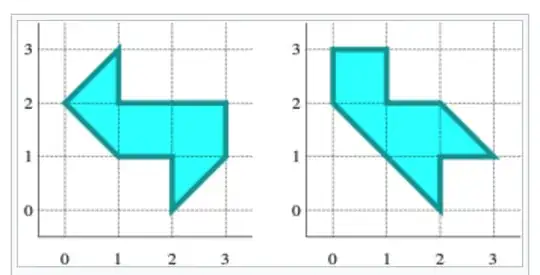

In the spirit of the no-words answer to the linked question:
two shapes made up of squares which have the same perimeter and area but which are different shapes
