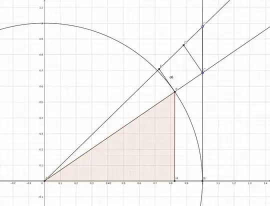

The following is maybe a little bit hand-wavy, but the idea is hopefully clear.
If $\theta$ is the angle $EAH$ in the figure, then $\tan \theta$ is the lenght of the segment $BC$. If we increase that angle slightly (or “infinitesimally”), then the segment $EF$ is approximately $d\theta$, and we would like to know the length of $CD$, since that's the change in $\tan \theta$.
Since the triangle $AHE$ is $\cos \theta$ times smaller than the triangle $ABC$, the segment $EF$ is $\cos \theta$ times shorter than $CG$. And $CG$ is in turn $\cos \theta$ times shorter than $CD$ (similar triangles; the angle $GCD$ is $\theta$ and the angle $CGD$ is $\pi/2$ up to an infinitesimal correction). So $EF$ is $\cos^2 \theta$ times shorter than $CD$, and thus $$ d( \tan\theta ) = CD = \frac{EF}{\cos^2\theta} = \frac{d\theta}{\cos^2 \theta} . $$

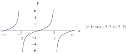

First, look at the graph of $\tan(x)$.
It has vertical asymptotes at integer multiples of $\dfrac{\pi}{2}$ and is undefined at $-\dfrac{\pi}{2}$ and $\dfrac{\pi}{2}$. Observe that from $-\dfrac{\pi}{2} \leq x \leq \dfrac{\pi}{2}$, the slope of $\tan(x)$ is always increasing. Notice that it increases faster from $-\dfrac{\pi}{2} \leq x \leq -\dfrac{\pi}{4}$ and from $\dfrac{\pi}{4} \leq x \leq \dfrac{\pi}{2}$. Then, let's take a look at the graph of $\sec^2(x)$.

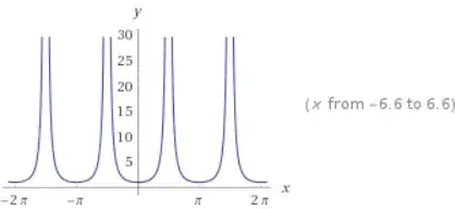

Observe that $\sec^2(x)$ is always positive as the slope of $\tan(x)$ was always positive. Also observe that $\sec^2(x)$ has vertical asymptotes at integer multiples of $\dfrac{\pi}{2}$. If we zone in on $-\dfrac{\pi}{2} \leq x \leq \dfrac{\pi}{2}$, then we see that the value of $\sec^2(x)$ is greater as we approach $x=-\dfrac{\pi}{2}$ or $x=\dfrac{\pi}{2}$. This is because we can think of the derivative as slope and previously saw that the slope was greatest near the asymptotes.
Therefore, it is natural for $\sec^2(x)$ to be the derivative of $\tan(x)$. The same technique will work for $\sin(x), \cos(x)$, and many others. If you are uncomfortable with the algebra then it is best draw a function and its derivative on graph paper.

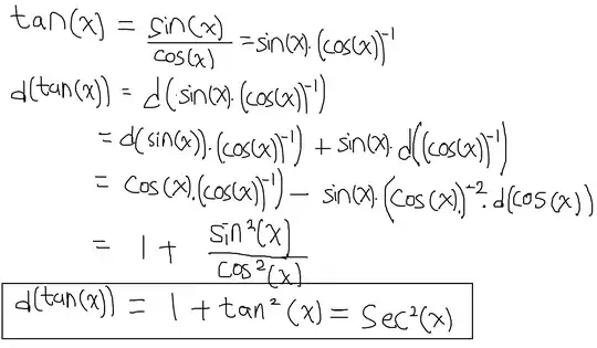

The easiest way to derive this would be the quotient rule, the other way is looking at the graph just like what Axion posted. I dont know how to derive it with unit circle/geometry way, sorry :) . But, instead of quotient rule i will just use product rule which is a bit inefficient because $cos(x)$ is in denominator (and i have to use chain rule for that), and it will do the trick anyway. So as you can see below the derivative of $tan(x)$ is just itself squared and the added by one, which by identities become $sec^{2}(x)$.
Edit : i just found the geometric way, please take a look on this post : Geometric Proof that $\frac{d}{d\theta}(\tan{\theta}) = 1 + \tan^{2}{\theta}$ Derivative of tan(x)
