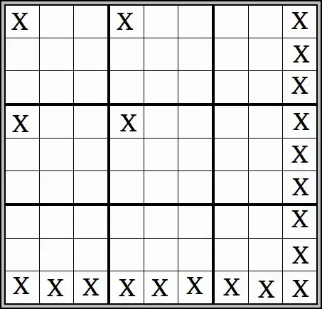

We can demonstrate, by hand, that $M \leq 60$.
Take any completed Sudoku grid and remove the following entries (marked by an X):
The solution to this Sudoku is fully determined and some subset of the remaining clues will constitute a minimal set of starting clues.
