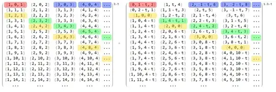

I believe I was able to show that $F_3$ contains all solutions for $d=3$. But I haven't been able to fully analyze $d=5,7,9$ in a similar way. The idea is in short simple and natural:
All palindromes with three digits are given with $Ab^2+Bb+A$ where $A,B<b$.
We can rewrite that as: $A(b+1)^2+(B-2A)(b+1)+(2A-B)$,
Now we can search for $2$-palindromes first, numbers palindromic in bases $b,b+1$:
We need now to satisfy (looking at digits of the rewritten expression):
$$1\le A-\alpha_1\le b$$ $$0\le B-2A +\alpha_1 (b+1) -\alpha_2 \le b$$ $$1\le 2A-B +\alpha_2 (b+1) \le b$$ To have a valid number, and to have a valid palindrome in base $b+1$: $$A-\alpha_1=2A-B+\alpha_2 (b+1)$$ Where $\alpha_1,\alpha_2\in\mathbb Z$ are freely used to "borrow" from and to neighbouring digits, to satisfy the first three conditions depending on $b,A,B$.
We can parametrize then all the $3$-digit numbers in base $b+1$ with some $t\in\mathbb N$:
(After preforming the trivial borrowing, we are observing bases $b+t,b+t+1$)
(Omitted the new $\alpha_1,\alpha_2$ gotten after trivial borrowing, from expressions, for readability)
And after this, we can show that the numbers on and below yellow line can't give base $b+1$ palindromes, and after further analysis and playing with conditions, one can show that $3$-palindromes must be numbers of forms located on green and blue lines.
Now we do the same thing, but for $b+1,b+2$ and considering only the blue and green forms, and after final analysis, one can finally prove and show that $F_3$ contains all $d=3$ digit $3$-palindromes, and that $d=3$ digit $4$-palindromes do not exist.
More specifically, the blue forms yield solution $300$ (see $F_3$), and the green forms yield the solutions generated by $b_3(b)$ that makes up the rest of $F_3$.
