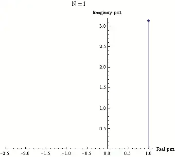

    What if you show him this picture? –  Mar 10 '13 at 11:16

This picture helped him understand
https://i.sstatic.net/PZO8h.gif
