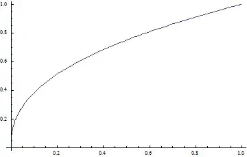

I would like to a good (8 bits accuracy) approximation for $x^{1/2.4}$ in the range $[0, 1]$. This transform is used for converting linear intensities to SRGB compressed values, so it's important that I make it run fast.
Plot of function:
Using a simple polynomial isn't practical because
  1. the function has lots of high order derivatives
  2. the function is roughly asymptotic to $x$, which is very different from the asymptotic behavior of high order polynomials

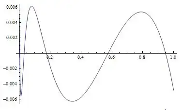

I tried the following Mathematica code
gx = GeneralMiniMaxApproximation[{t, 1 - t + t^(1/2.4)},
                             {t, {0, 1}, 3, 3}, x,
                              MaxIterations -> 200, WorkingPrecision -> 50]
and then
hx = gx - 1 + x
This gave an approximation $hx$ of your function
$$ \frac{x^4 - 1.3730926529x^3 - 1.2231795079x^2 - 0.0120332034x - 3.892203211 \times 10^{-7}} {x^3 - 2.47604929086x^2 - 0.13996763348x - 0.00008072719}$$
The error function looks like this:
error-plot
Not quite 8 bits, but getting close. You can fiddle with the degrees of the numerator and denominator to try to get something better.
