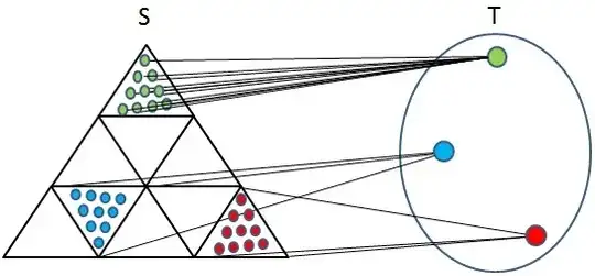

As it as been remarked : when you say "same as", for example with "x' has the same age as x" is like saying "a(x')=a(x)" ; otherwise said, $x'$ and $x$ are in the same pre-image $a^{-1}(...)$, for example $a^{-1}(21)$ if both $x$ and $x'$ are 21. There are "as many" equivalence classes as there exists pre-images (see figure below).
In a reverse way, if you have an equivalence relation on a certain set $S$, it determines a partition of $S$ with cardinal $C$ ("number of classes" with possibly a generalized meaning). You will always be able to build a function $f$ from $S$ to a any set $T$ with cardinality $C$ like $\{1,2,...,n\}$ or $\mathbb{N}$, an interval $[a,b]$, $[a,b)$ of $\mathbb{R}$, etc., such that the any equivalence class is mapped onto the same element that we could call a (generalized) "label".
Thus the answer to your question : all equivalence relations can be put into the same "mould" : $x'$ is equivalent to $x$ iff $x'$ has the same "label" as $x$.
Fig. 1 : mapping "a" between elements belonging to equivalence classes in set $S$ and "labels" (set $T$). In this way equivalence classes appear as "pre-images" $a^{-1}(\ell)$ of the different "labels".
