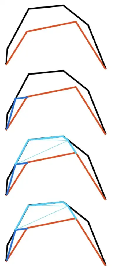

The first inequality is easier to justify by comparing areas(How to prove that $\lim\limits_{x\to0}\frac{\sin x}x=1$?), but I suppose the more interesting question is the inequality
$$\text{length}(y_1) \leq\text{length}{(y_2)}$$ under the assumptions that the graphs $y_i$ are concave, $y_1\le y_2$, and $y_1=y_2$ at the endpoints. You can prove it first for polygonal graphs, and then approximate the continuous graph by a sufficiently detailed polygonal graph.
For polygonal paths, you can proceed as follows. The result is obvious(triangle inequality) if $y_1$ is flat. Otherwise, extend the 2nd segment of $y_1$ backwards until you hit $y_2$ at say $X$. The resulting path obtained from going along $y_1$ until $X$, then switching to $y_1$ is strictly longer than $y_1$, by triangle inequality a large number of times. Now we can ignore the curves up to the point $X$, so we have reduced the number $n$ of segments of $y_1$. The result follows from induction in $n$.
A visual aid -
A visual aid
