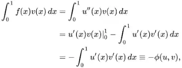

In Finite element analysis, we turn a differential equation into its weak form by multiplying both sides of the DE by a test function and integrate over small sections of the interval of interest.
I know that one reason we use the weak form is that there are now less restrictions in the solution; the solution to the weak form of the problem doesn't have to be as many times differentiable as a solution to the original function, for example.
But this can't be the only reason why weak forms are used. Solution to the weak form has to approximate the solution to the original problem as well. So why is this? Why does it make sense that a solution to the weak form of the problem is anywhere related to the solution of the original problem? If we multiply to sides of the equation by some function, integrate, and find a solution that satisfies this new relation, why does it seem to imply it approximately solves the original problem as well?
I don't need very deep mathematical reasoning for this. I am an engineering student, but I would like to have some intuition on this.
I read one explanation somewhere that if the test function has an integral of one over some interval around $x_0$ and we carry out the multiplication and integration procedure, the integral approximately equals the value of the function multiplied by the test function at $x_0$. I tried this with some functions and it seems to be true. I also remembered from a math lecture some years ago that the integral of a function multiplied by the Dirac delta over some point (and Dirac delta has an integral of one!) equals the value of the function at the point the Dirac is located. Does this have anything to do with the reason why the solution to the weak formulation works? But I still can't find a good intuition why the sum of the test/basis function approximates the solution over the interval.

First the important part of finding weak solutions to PDEs is rewriting a PDE into the weak form aka \begin{align} L(x)=0 \Rightarrow \int L(x)v \ dx=0 \end{align} where $L$ is some differential operator (using the integration by parts bit makes finding numerical solutions easier but it is not strictly nessary). From the fundamental lemma of calculus of variations for the integral to be equal to zero for any continuously compactly supported function $v$, $L(x)$ must be equal to zero. By writing the PDE in this form any true solution is also a solution to the weak form, but not every weak form solution is a true solution to the original PDE problem. If you want a nice example of what I am talking about see the answer to this post. In general though the weak solution can be very different from the true solution (they do come from different function spaces very all). One of the major realizations in the practical applications of PDEs to real world problems was that the weak solution of a PDE is often "Good Enough". I had a book that talked about the history of this but I can't find it :( .

    Equations of the theory of elasticity need to be solved in a given domain for finding an equilibrium configuration of a deformable elastic body. This is a strong form of the problem. At the same time, the total mechanical energy (strain energy of the body + potential energy of externally applied forces) is at minimum in an equilibrium state, which means that a certain functional needs to be minimized with respect to the unknown field of displacements for finding the solution. This is a weak form (one among many possible). Both formulations are mathematically equivalent, but allow for different numerical methods for finding approximate solutions. Typically, one uses finite difference method for solving differential equations and FEM for minimizing the total energy.
  • Then apply the Lax-Milgram Theorem to the weak form. The theorem works because function spaces are vector spaces and we can apply the results of linear algebra to the weak form (if it is linear or bilinear).
