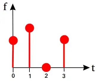

Suppose we have a real-valued, discrete-time function with compact support $f : \{0, 1, 2, 3\} \to \mathbb{R}$. Here is a plot of that function,
plot of our discrete-time function
and here are its precise values, $$ f := \begin{bmatrix}1 \\ 1.3 \\ 0 \\ 1\end{bmatrix} $$

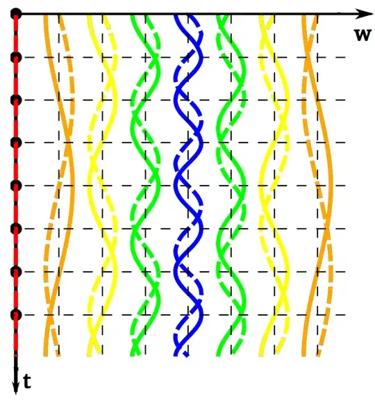

We are interested in a specific basis known as the "Fourier" basis. The Fourier basis can be defined for a vector space of any (including infinite) dimension, but here it is for our case of 4 dimensions: $$ \Omega_4 := \Big{\{} \begin{bmatrix}1 \\ 1 \\ 1 \\ 1\end{bmatrix}, \begin{bmatrix}1 \\ i \\ -1 \\ -i\end{bmatrix}, \begin{bmatrix}1 \\ -1 \\ 1 \\ -1\end{bmatrix}, \begin{bmatrix}1 \\ -i \\ -1 \\ i\end{bmatrix}\Big{\}} $$
(Note I have left out a scale factor of $\frac{1}{\sqrt{4}}$ for notational clarity).
As with any new basis, our $f$ in the original basis can be expressed in the Fourier basis by solving, \begin{align} F_{t\omega}f_\omega &= f_t\\ \\ \begin{bmatrix} 1 & 1 & 1 & 1 \\ 1 & i & -1& -i \\ 1 & -1 & 1 & -1 \\ 1 & -i & -1 & i\end{bmatrix} \begin{bmatrix} f_\omega(0)\\ f_\omega(1)\\ f_\omega(2)\\ f_\omega(3)\end{bmatrix} &= \begin{bmatrix} 1 \\ 1.3 \\ 0 \\ 1 \end{bmatrix}\\ \\ f_\omega(0)\begin{bmatrix}1 \\ 1 \\ 1 \\ 1\end{bmatrix}+ f_\omega(1)\begin{bmatrix}1 \\ i \\ -1 \\ -i\end{bmatrix}+ f_\omega(2)\begin{bmatrix}1 \\ -1 \\ 1 \\ -1\end{bmatrix}+ f_\omega(3)\begin{bmatrix}1 \\ -i \\ -1 \\ i\end{bmatrix} &= \begin{bmatrix} 1 \\ 1.3 \\ 0 \\ 1 \end{bmatrix} \end{align}
where $f_t$ is $f$ expressed in terms of the $t$-basis, $f_\omega$ is the same vector $f$ expressed in terms of the (Fourier) $\omega$-basis, and $F_{t\omega}$ is the change-of-basis matrix who's columns are the Fourier basis vectors. Taking a "Fourier transform" means solving this equation for $f_\omega$ given $f_t$. Special properties of the Fourier basis, namely orthogonality, make inverting this matrix as easy as taking a complex conjugate, leaving just a matrix multiplication to be done. Further, special symmetry properties of this matrix allow for an even speedier multiplication known as the "fast Fourier transform" algorithm, "FFT".
So with these definitions, it is clear that the Fourier transform is just a change-of-basis, and in a finite-dimensional setting, can be explicitly written with matrix operations. What is left is to write the Fourier basis in terms of an $n$-dimensional space and then try to imagine what this matrix looks like as $n \to \infty$ (for when $f : \mathbb{R} \to \mathbb{R}$). The general expression is that the $t$th-row and $\omega$th column of the $n$-dimensional matrix $F_{t\omega}$ has value $\frac{1}{\sqrt{n}}e^{i t\omega/n}$. Holding $\omega$ fixed means looking at all the rows down a specific column, and we see that those values are a discretized complex sinusoid on $t$. Graphically: DFT COB Matrix Concept
